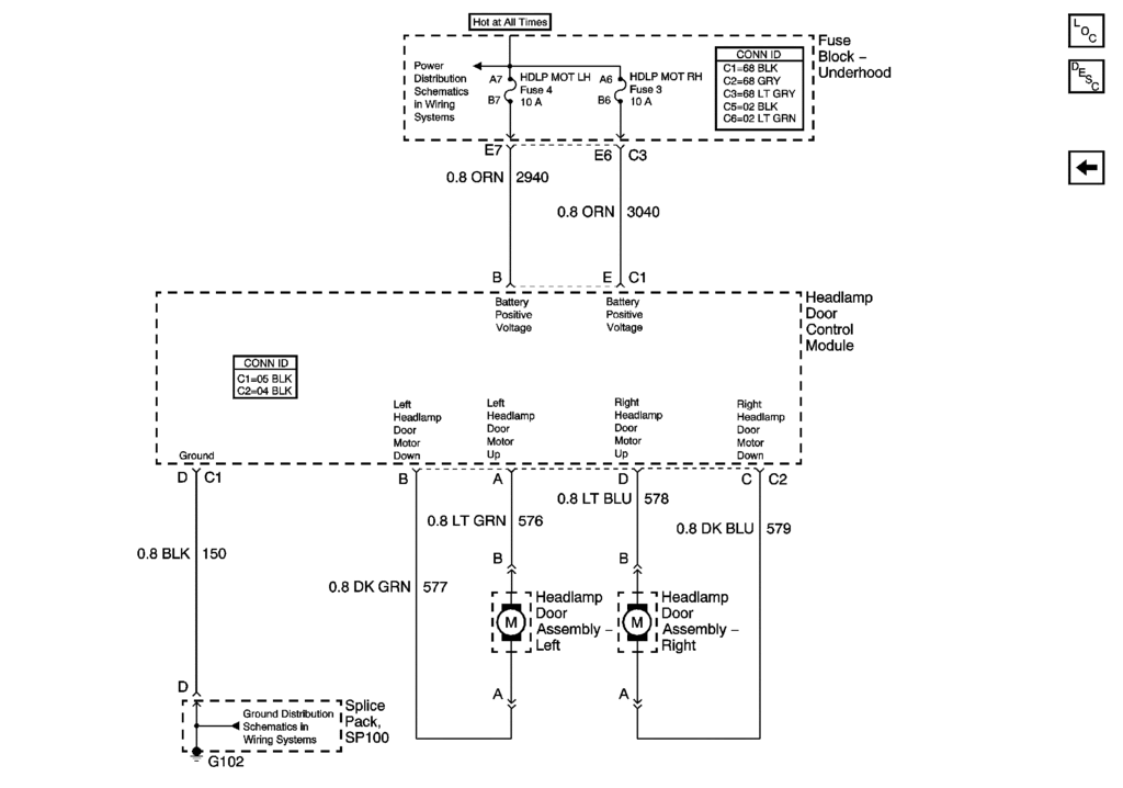

I put my lights on and only one came up? Never had this happen before. Would there be a separate fuse for this?
Thank You. This is on my 2001.

Check with a test light for power, I'm guessing your gear in the assembly is stripped easy fix lots on you tube to show you how, if you turn the manual **** will tell you if its the gear

Check the easiest thing 1st. YES, there are fuses for the left and right motors. Happened to me-changed the fuse and all was well.

As mentioned above, yes. Underhood Fuse Block, Fuse 3 for the right motor and Fuse 4 for the left one.

Have you verified you can spin the motor by hand to raise the lamp?
I had an issue where my lamp didn't come up but I ended up loosing the pin for the lifting arm.

Thank you all for your input...…….I pulled the #3 fuse and it was good but ……….when I put it back in the light door opened
must have had some corrosion on the fuse or contact.....Polished it up put it back in. Thanks again.
