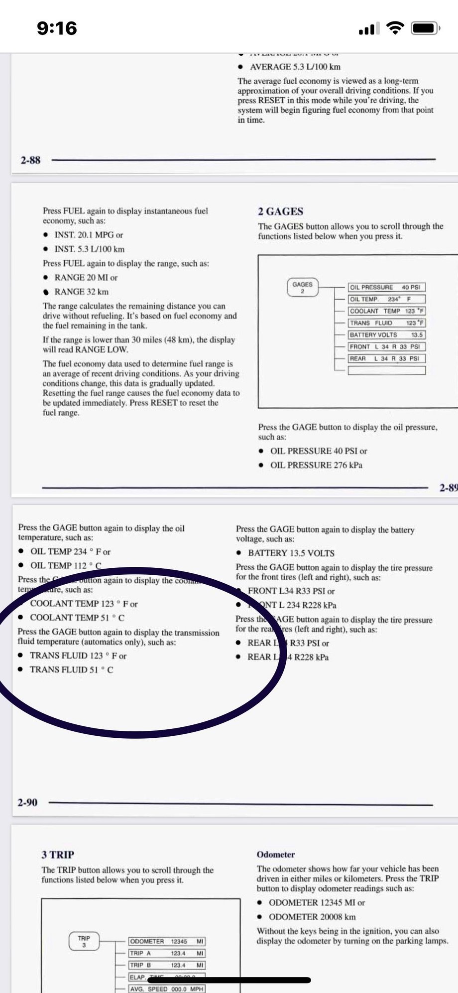

what does the low transmission fluid light look like on 98 c5 corvette?

Welcome to the Forum but sorry no such animal...you can read it through the DIC using the gauges button...see your owners manual page 2-90...if you don’t have it you can download it from the Internet !!
