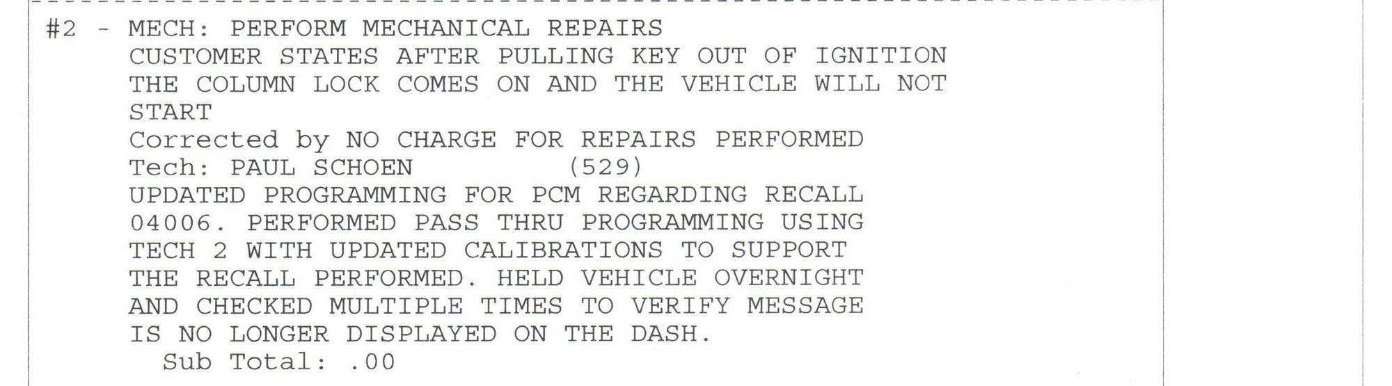

Below is what they did for the recall. One of my concerns is that when it when in the 2nd time they installed a harness kit for an Automatic when mine is a Manual.

According to Complianceparts website, you do not need to remove any GM recall. Its suppose to fix all the issues with the column lock Including the dash warnings. And from everything I've read on this forum they have excellent customer support

Did the previous owner do the Brown Wire procedure that is part of the LMC5 installation? If yes and/or do not know, I suggest calling Richard at Compliance Parts, 855-565-8388. Super #1 customer service.
