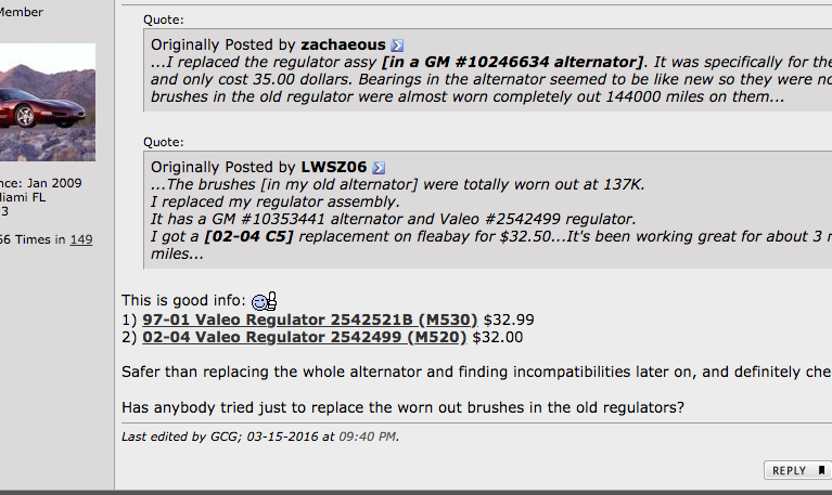

It's actually called a decoupler. It acts like a sprag clutch and eliminates belt related issues/NVH on automatics at idle.
The concern with getting an aftermarket alternator is because the voltage regulator has a special circuit that if missing throws charging system fault messages. If you do get an aftermarket alternator, the key is having the correct regulator.

I have an autozone alternator 110 amp and works great, I have more than 14.0 volts all the time at the battery, I do get the charge system fault message, but I just delete it. I still have my original core though. I never had 14.0 volts at the battery with the original Valero.
