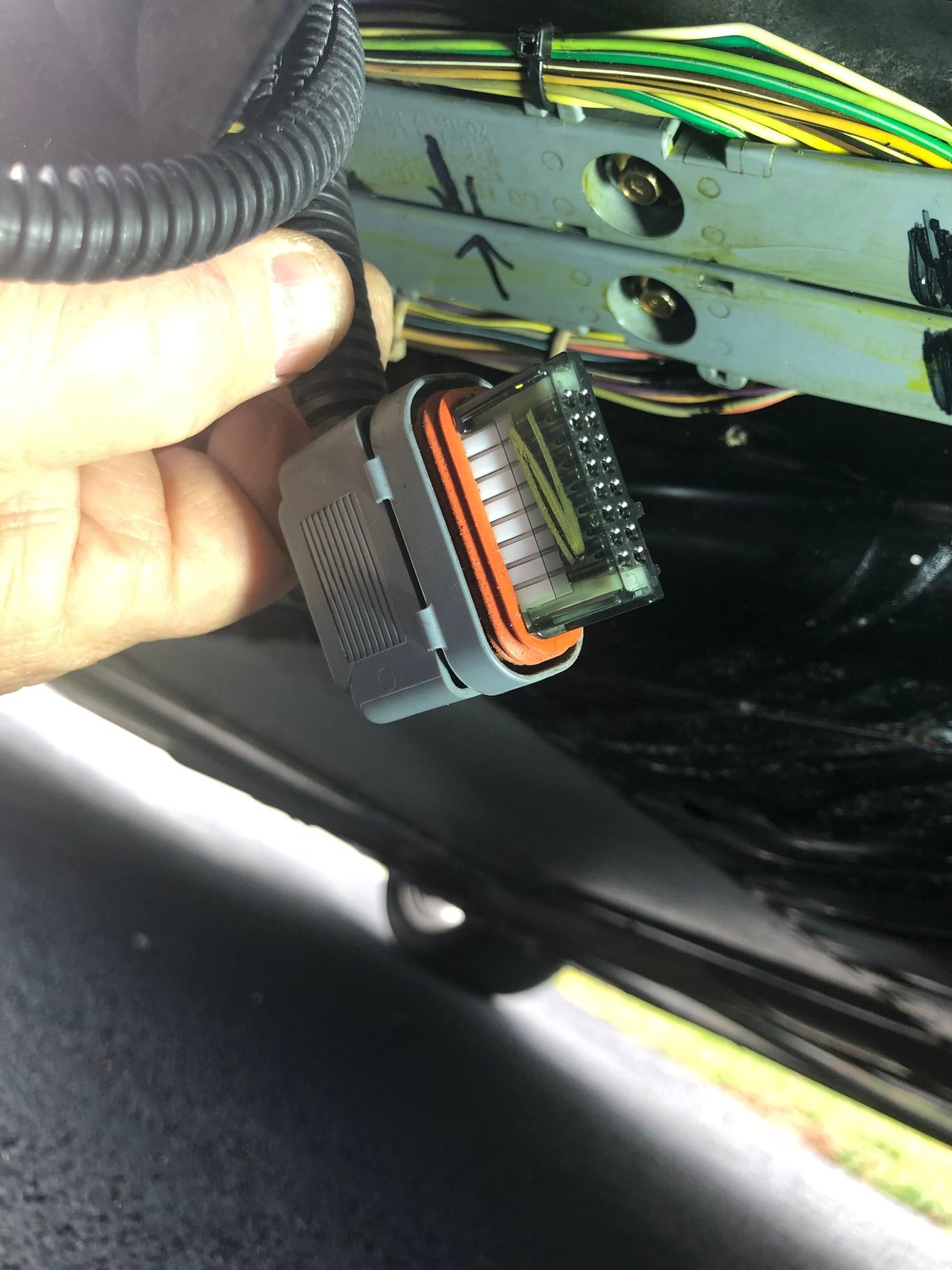

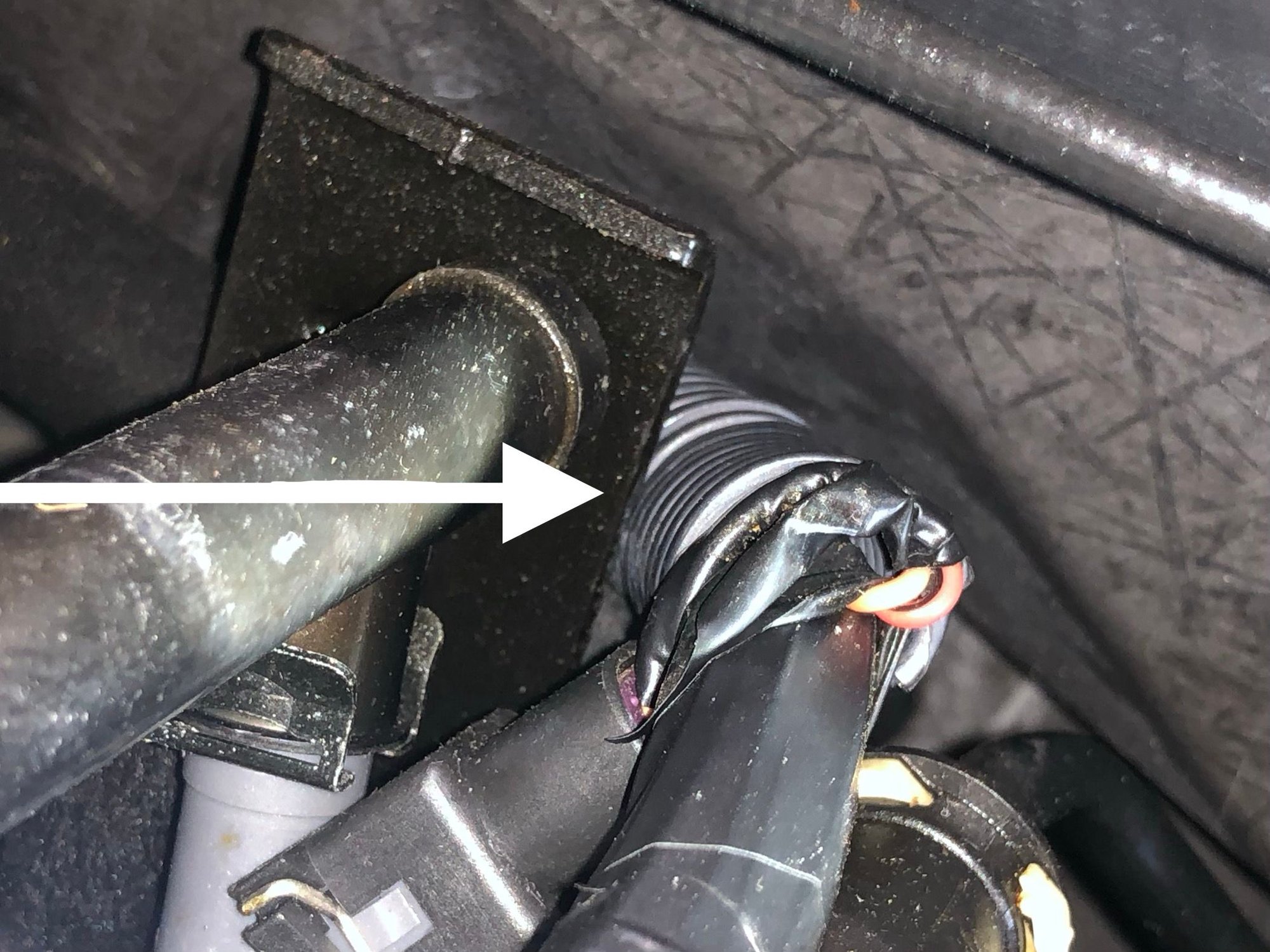

Well I don’t know if you are going to try the diagnosis but you will need to access the TAC module which resides next to the PCM...remove the harness that has a pink wire in it...it’s Connector C2 Pin 7...I don’t have the connector view in front of me but I think it may be the larger connector of the two...you may have a short to ground on that wire from the fusebox to the harness or a bad TAC module...if you replace the fuse and remove the connector and with key on the fuse blows again the wire may be chaffed somewhere...if it doesn’t blows sounds like a bad TAC module !!..some pictures below.

I'd try the “wiggle test” while the engine is running....I would concentrate on shaking the wiring at the TAC servo motor and TPS sensor...you may have a chaffed wire somewhere under the hood where there are more vibration...try to follow the wire loom back from both components...I don’t think you can buy a “new” TAC Module these days !!...I’d have to look but I think the servo motor wiring runs behind the fuel rail bracket where a lot of chaffing occurs !!
