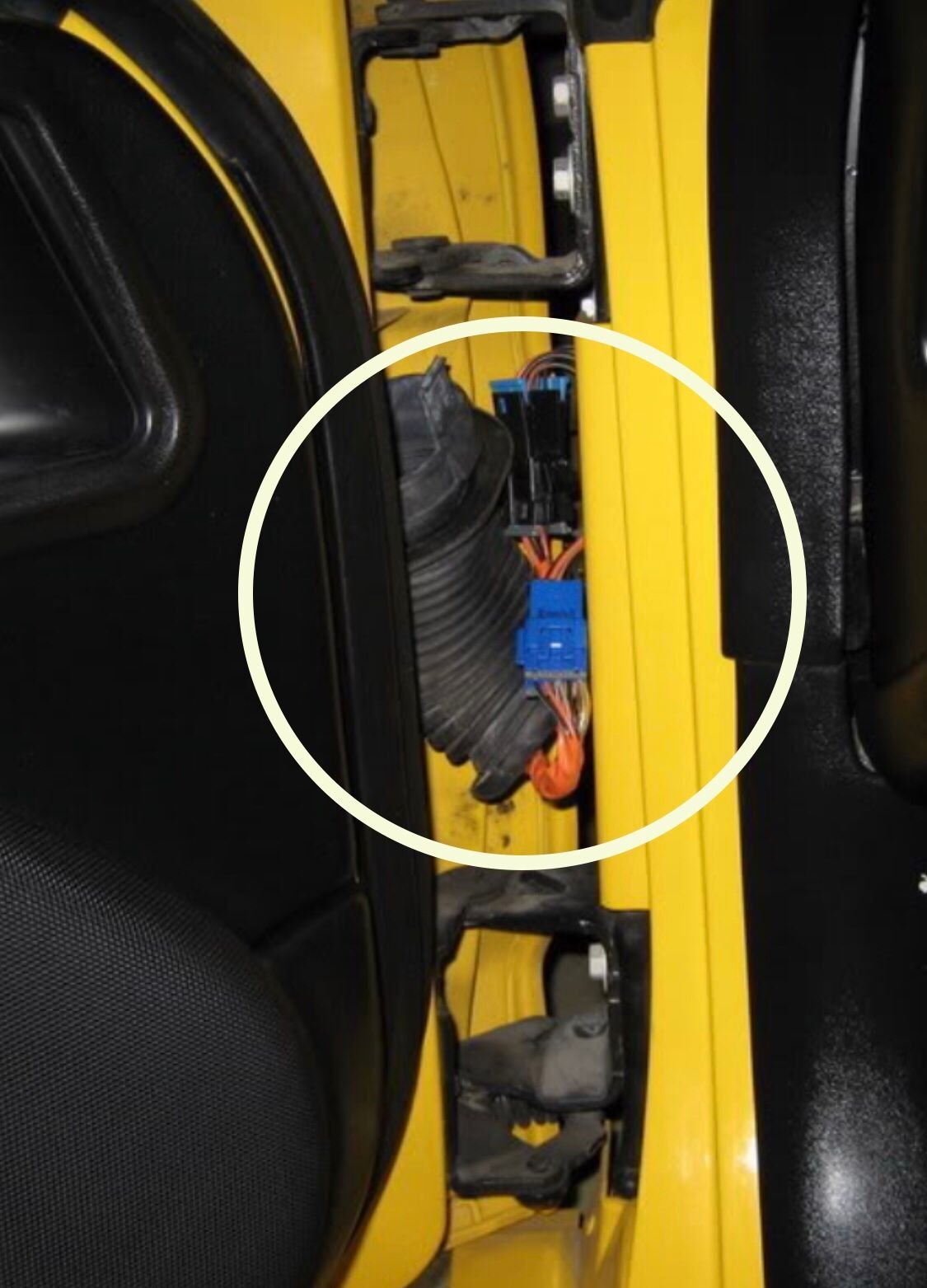

I don’t know how long the mechanic had the car but it shouldn’t be more than a 5-10 minute diagnosis !!...anytime I have a car that won’t start or start and stalls I also have my scan tool and CAN test box hooked up !!...if you can’t get the scan tool to communicate with the cars modules...“NO COMMUNICATION” ...it’s usually a network issue. If a module (BCM, PCM, HVAC,SCM etc loses power or ground that power or ground can “backfeed” onto the serial data line and give you those issues your having..with the key ON do you see your fuel gauge go to E and your water temp maxes out...also your power windows don’t work and you have all the DIC warnings...”Reduced Power”, Service Engine Soon, Low Fuel ??...a lot of these issues can be traced to the connection in the Driver Door Module...there is a connector inside the rubber boot when you open the door that connects the door to the cars frame...shake that boot and now see if the car starts ??

I edited my last post and included a picture !!...3 years ?????...I’m sure this mechanic had no diagnostic skills !!

If you can find the 2 splice packs to the left of the BCM in the passengers footwell pop the “comb” we call it from the top of the splice pack (squeeze the ends of it pull it off) it is the one with 4 wires as in the video...now see if the car starts !!

Well I wiggled the rubber boot and she started right up and stayed on!! You're a freaking genius! I still have a lot of codes pulling up.

You can delete all of those codes now either with a scan tool or through the DIC !!...you have to gain access to that connector and look for any corrosion or loose or bent pins...if not it may come back !
