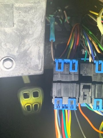

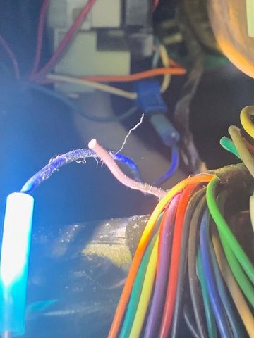

Well I changed the hazard switch and brake light switch at the break pedal and the lights are working. Now for the rest of the story. I have issues with the cruise control and I have already bought the turn signal switch so I decided to change it out. I noticed a strange wire connection when I was changing the break switch and when I got into the turn signal switch I can see what that connection is all about. For some reason someone clipped the small brown wire on the left side of the harness then connected a blue wire to it to run a jump to the white wire on the break switch. I think the turn signal switch went bad and this is someone's way around replacing it. I think I am going to disconnect the jumper and reconnect the brown wire when the turn signal switch is replaced. Anyone have an idea what hat brown wire is for? I have attached pictures below.

Looks like that jumps out a contact in the hazard switch.
With the hazards on, pressing the brake pedal should not affect the hazards or cause the outside brake lights to come on continually. I expect your brake pedal will affect the hazards flashing.

You may be on to something there. I put the new hazard switch on first and all the lights flashed where as before only the fronts flashed. That's when I decided to change the pedal switch and the break lights started working but the front hazards once again only work. They also hyper flash even though I have the Vette Lights Anti Hyper Flash unit installed. I can't understand the wire mod and why it was done. I wonder if the new hazard switch has been effected by this jump wire.

Okay for those of you who have followed this post I want to thank those of you who have provided constructive feedback and advice. For the those who feel that this forum is for trolling and giving negative responses.....grow up I pay for this subscription for advice and providing advice when I believe I have valued input. Now with that said.... BAM all lights are working like factory now thanks to your comments and support. I may have spent a little more than I should have replacing the brake switch, turn signal switch and hazard switch but it is worth in. Lets be honest my 99 is 21 years old and would have needed all of them changed anyway at some point. Anyway I changed all the switched and did away with the jumper wire and reconnected it to the factory position and bam everything works as it should. Thank you to all that provided constructive feedback could not have done it without you!
