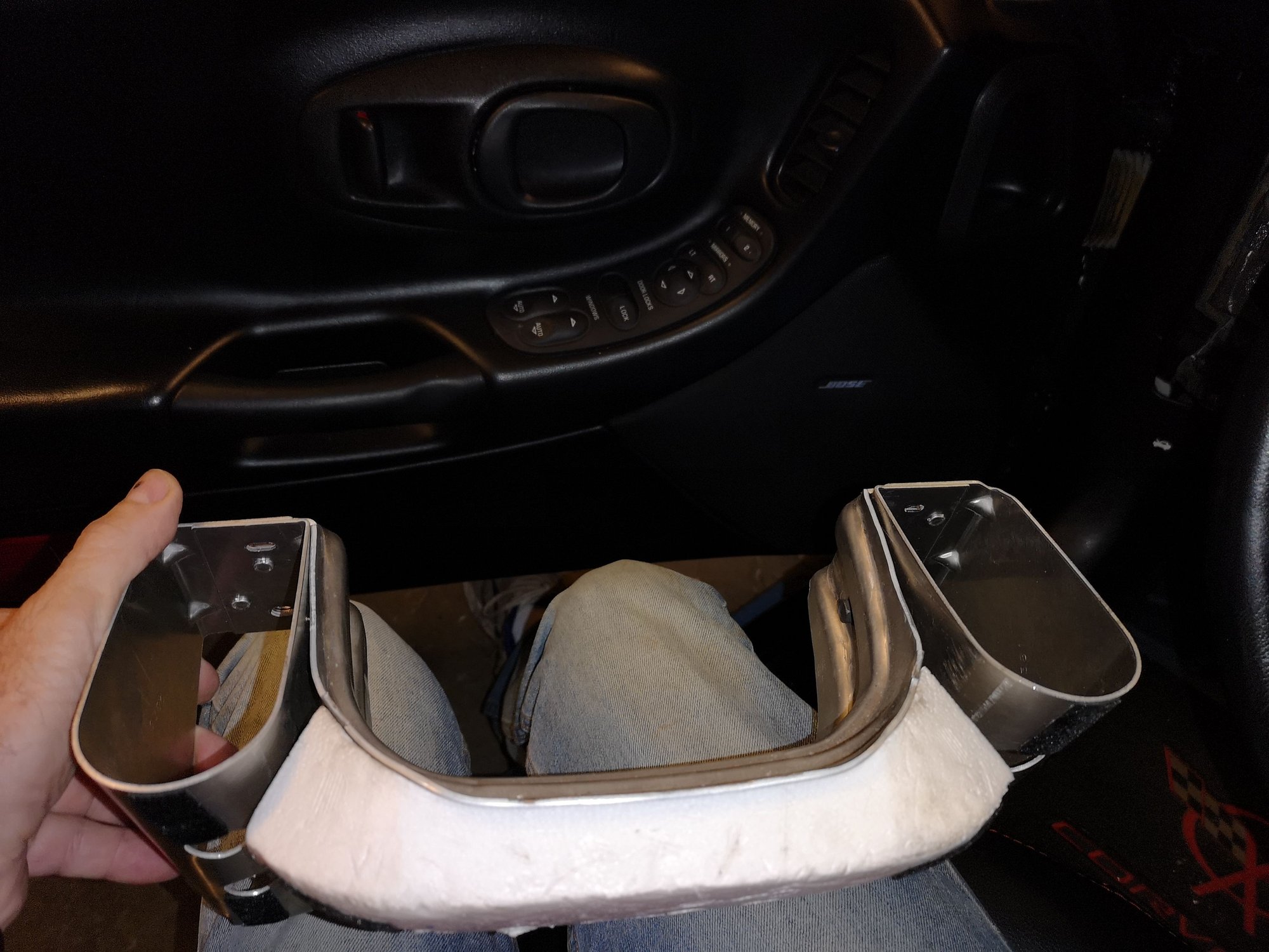

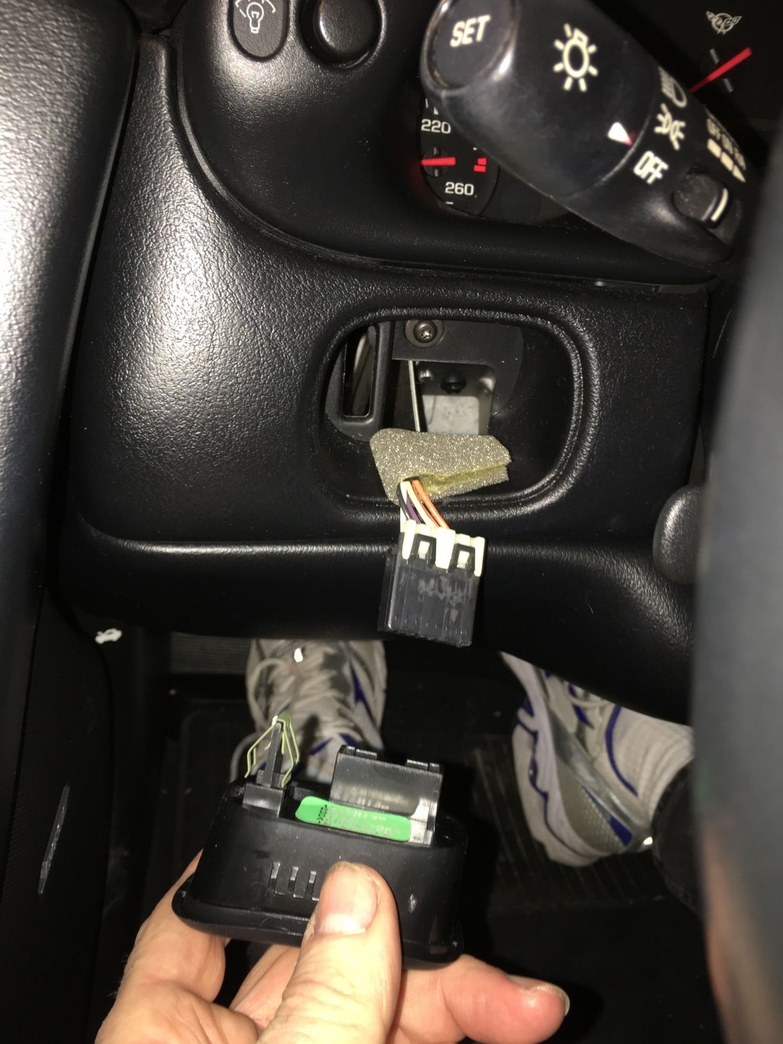

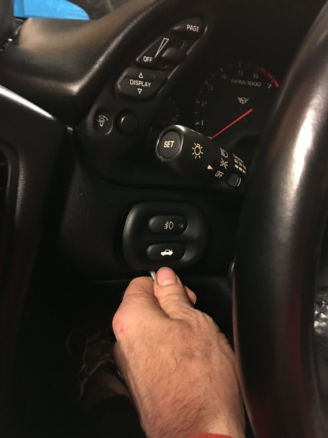

I don't use more than approx 15 min to remove my cluster from the car .
These photoes show how I do it without removing my center console
