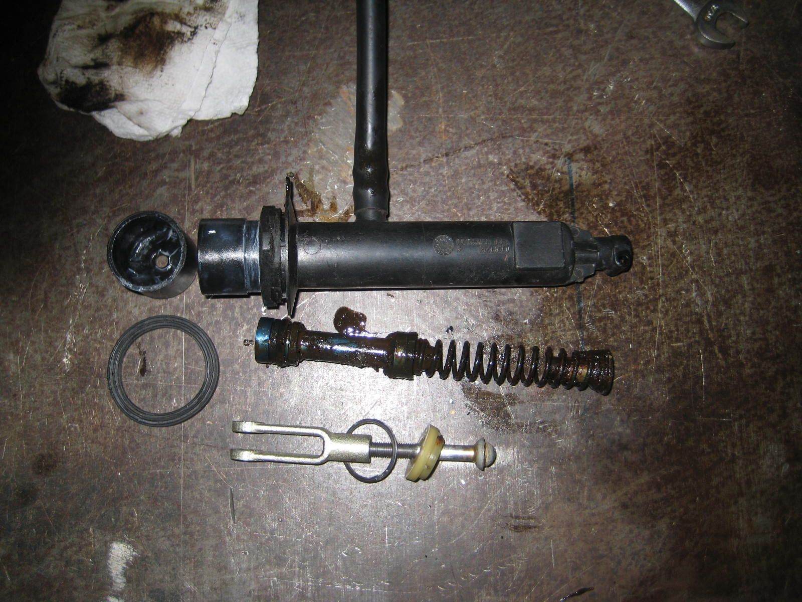

Here is a photo of a clutch master disassembled. (note there is not a repair kit for these, so this is a donor master) Notice all the crud on the spool and the spring. At the end of the spring is a small cap that serves two purposes, it provides a base for the internal spring, and has a hole that acts as a flow control orifice in in case your foot slips off the clutch. This end gets filled with clutch dust that is sucked past the slave cylinder seal. This dust becomes a gooey sludge and eventually prevents fluid movement into the slave. Then, one of the spool seals ruptures or cracks and you can't develop pressure in the master to move the slave: This one blew by the seals on the spool and leaked inside the car on the firewall. (BTW, the linkage fork is not OEM)
Below is the end piece for the spring with the hole in the end. Sometimes you can save the master by removing it, driving out the little spring pin that holds the high pressure line in the cylinder body and cleaning the master with a pipe cleaner. We did this many years ago before someone thought up the idea of a remote bleeder.
Once your clutch gets sticky, all the rangering in the world won't clear up the problem. A new master/slave and a remote bleed line is the cure.
