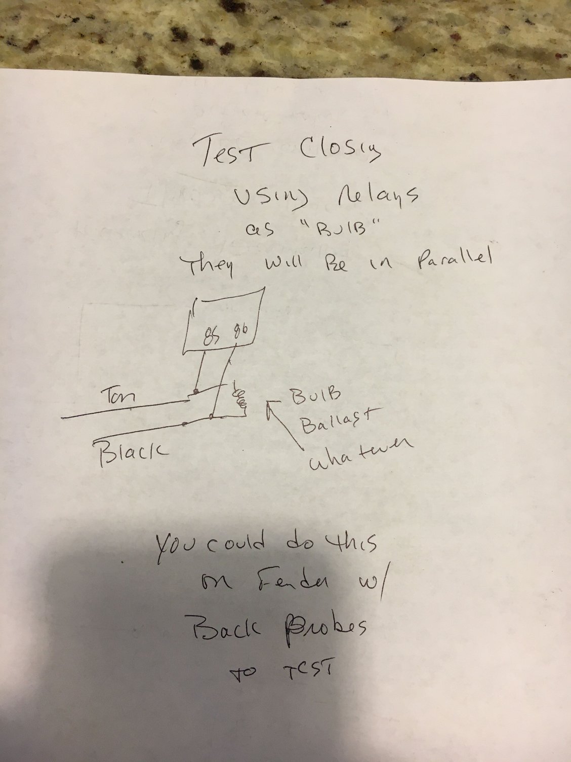

Actually I do because I was the one who told RadiioFlyer/SharpLight Innovations how to resolve the issue they were having with their kits. I even have video of me cycling my doors with NO headlights installed.
If you have installed LED bulbs and the doors don't work, here is your solution. This draws virtually no current and creates no heat like the aftermarket power resistors do. It's so simple, you could even just install a mini bulb and have the same effect. Let me see what I can find in my texts and I will post. One note - the relay needs to have a resistor in it, not a diode. That is found on the relay schematic and if you do not understand, I can explain.

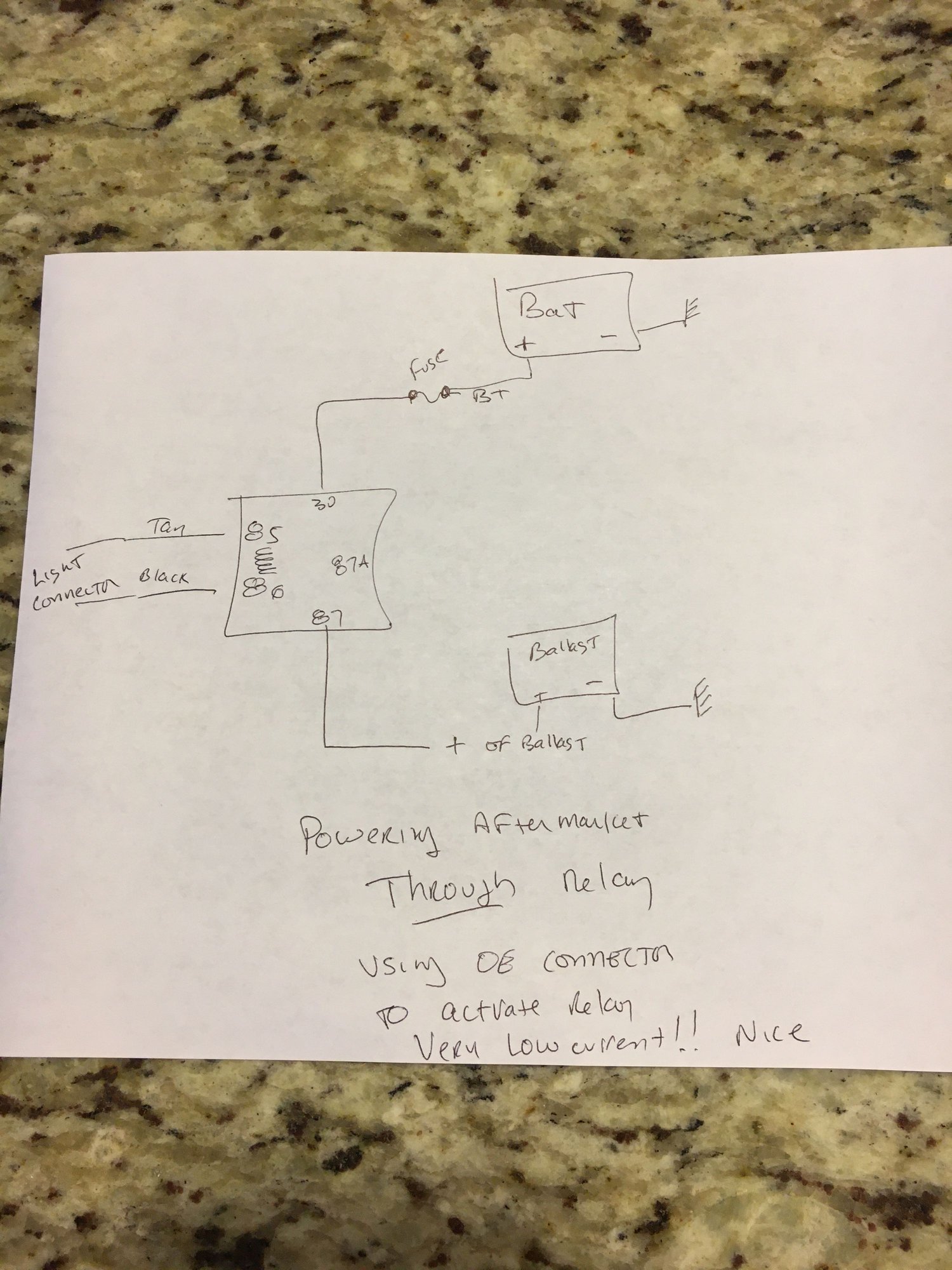

Old Aug 14, 2020 | 11:21 AM
Ed Ramberger's Avatar
Ed Ramberger
Joined: May 2008
Posts: 1,695
Likes: 490
From: Denver, NC
This is how you you should power a harness you are running off the factory connector. This is why RF lights had the problems, they were not using the ACA harnesses with the relays, and there was no continuity through the circuit for the module to trigger and
close the door.

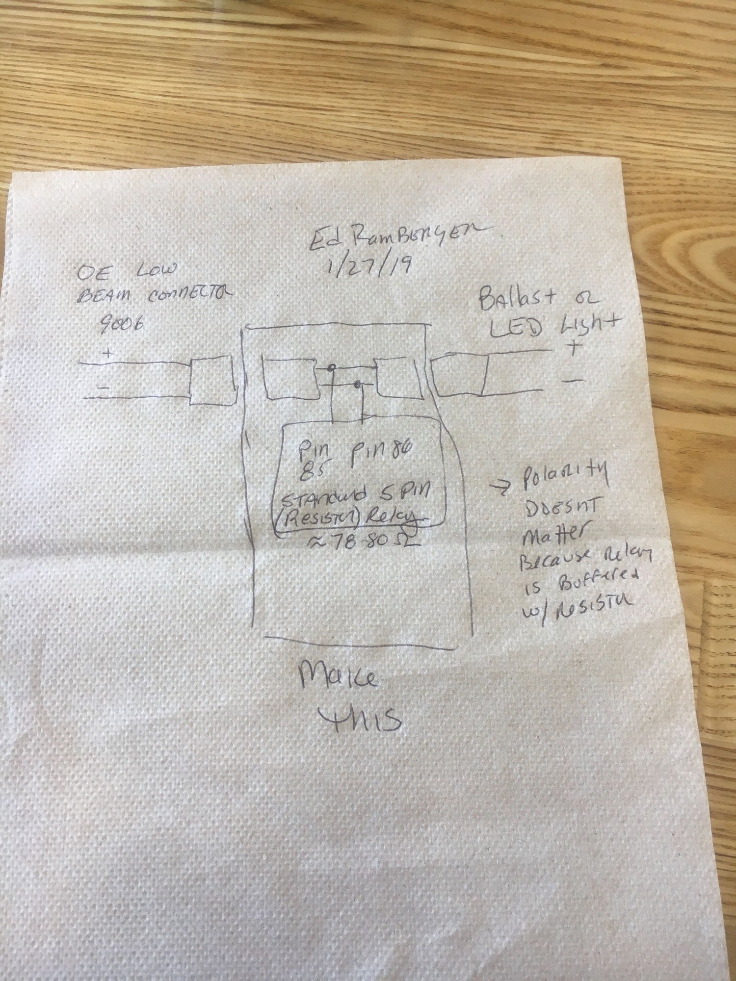

Old Aug 14, 2020 | 11:24 AM
Ed Ramberger
Joined: May 2008
Posts: 1,695
Likes: 490
From: Denver, NC
This is what I suggested they build for all their kits that were having problems because they were running ballasts straight off the car socket instead of through a relay as referenced in previous post) - connectors are easily avail aftermarket.
