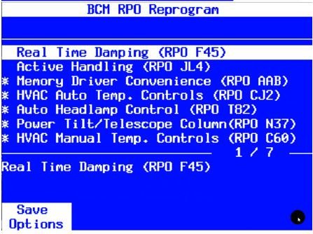

Hello again friends. Looks like I will be replacing my 2000 Convertible's BCM with a reman unit. Can you guys enlighten me on what the reprogramming process actually is and who can do it? I understand you need a Tech2 or similar device and proper software. Do most auto electric shops have this equipment and software, or just dealers? Average cost? When I hear talk about flashing or re-flashing the BCM, what is that exactly? How is that different from reprogramming a reman unit? Thanks to all! Appreciate the support here.

Any decent shop and not just a Dealership should be able to program a module...even a friend of mine who owns an AAMCO transmission shop does programming. Here are a couple videos...

There is no tune for the BCM(BodyControlModule) , only RPO configuration of these RPO's.
As mentioned by C5 Diag it can be done by most di directional scanners like Tech2,Tech2win , Autel ...

You definitely do not program the key resistance into the BCM. It's a relearn procedure. You can do it without the TechII.
You certainly could get someone with a bench setup to program the options if you gave them the options to set and then do the VATS relearn yourself.
You can also do the VATS relearn yourself and then drive it to the shop to get the RPO codes set.

There is only one relearn procedure and it's for the VATS.
The shop will set the BCM to match the RPO options, not reflash it.
