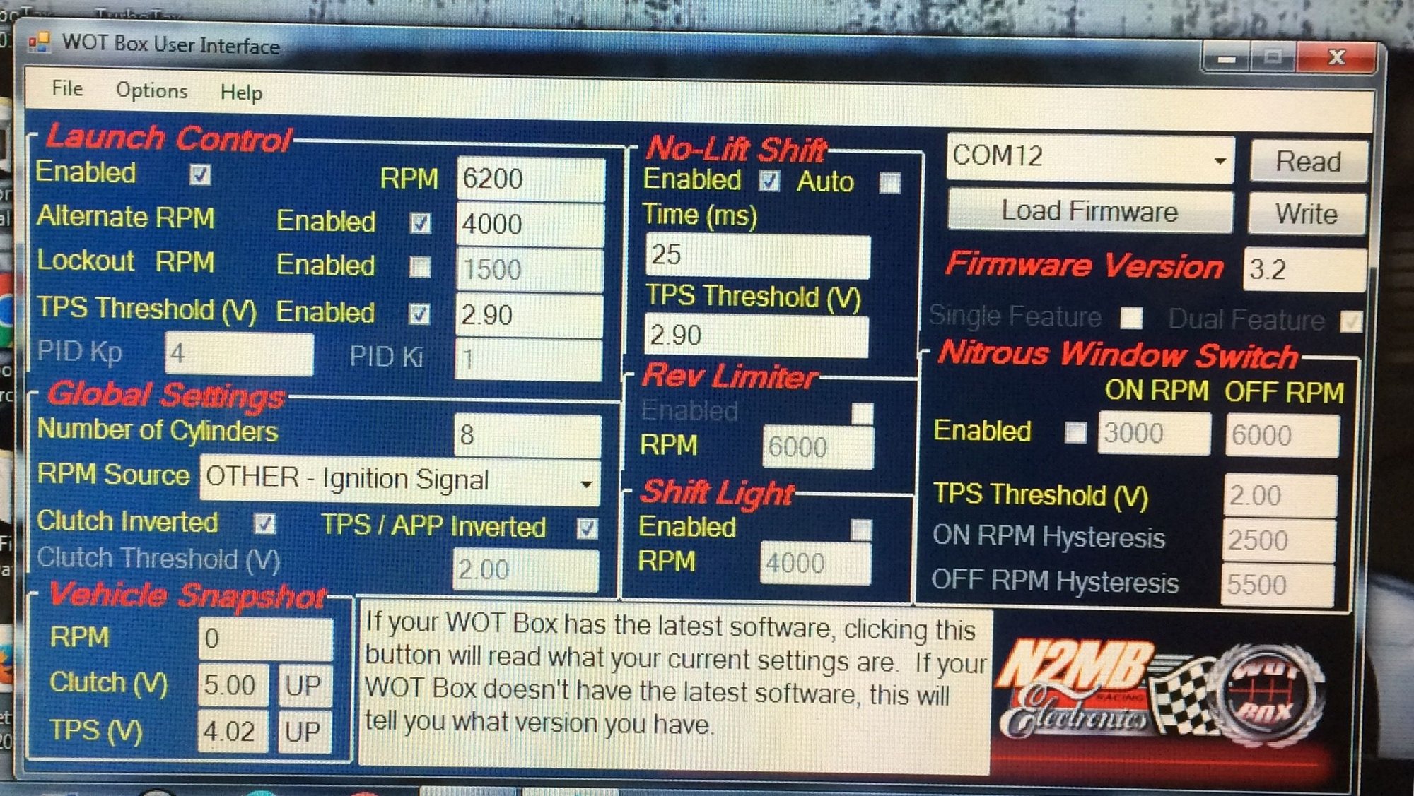

So I installed a n2mb wot box on my 2002 z06 and I am running into an issue. The car will cut the ignition randomly between 1900-2000rpms and cause the car to fall on it’s face. I ran through the help on their website and I still can’t seem to find my problem. When I turn the ignition ON the light on the wot box blinks rapidly and when I press the accelerator it continues blinking. When I press in the clutch and release the light will go out then continue to blink rapidly. The 2 step does not work either. Anyone know what I should look for to fix this issue?
car runs perfect when I turn wot box off

Copy my settings then you can fine tune them to your setup, if it still has issues then it may not be wired correctly

Copying your setting helped the car run way better and how it should. I’ve talked to n2mb and they said there is an issue with my blue wire. My blue wire is tapped into the dark green wire on the throttle position sensor. When I do the vehicle snapshot with throttle up tps voltage is 4.10 similar to yours. When I press throttle all the way down then voltage reads only 2.98 which should be reading 0. Any ideas??!
