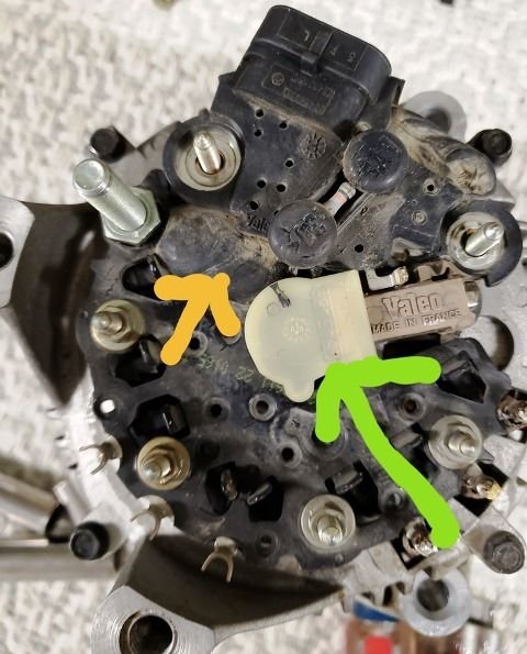

Standup triple: Do you have the link for the voltage regulator INSTRUCTIONS? I already had GCG's part source link.
I've removed the 2 8mm nuts, but the regulator appears to be hanging up by something under the rubbery blob (orange arrow) or under the bushing cover (green arrow)

...I've removed the 2 8mm nuts, but the regulator appears to be hanging up by something under the rubbery blob (orange arrow) or under the bushing cover (green arrow)
Yes, in addition to the two 8-millimeter nuts, under the "rubbery blob" (orange arrow) there are 2 contact rings that need to be freed. You also need to remove the plastic cover (pull it straight away) that protects the brushes (green arrow) so you can push them up a little to facilitate the removal of the old voltage regulator. See pictures below to have a better idea:
