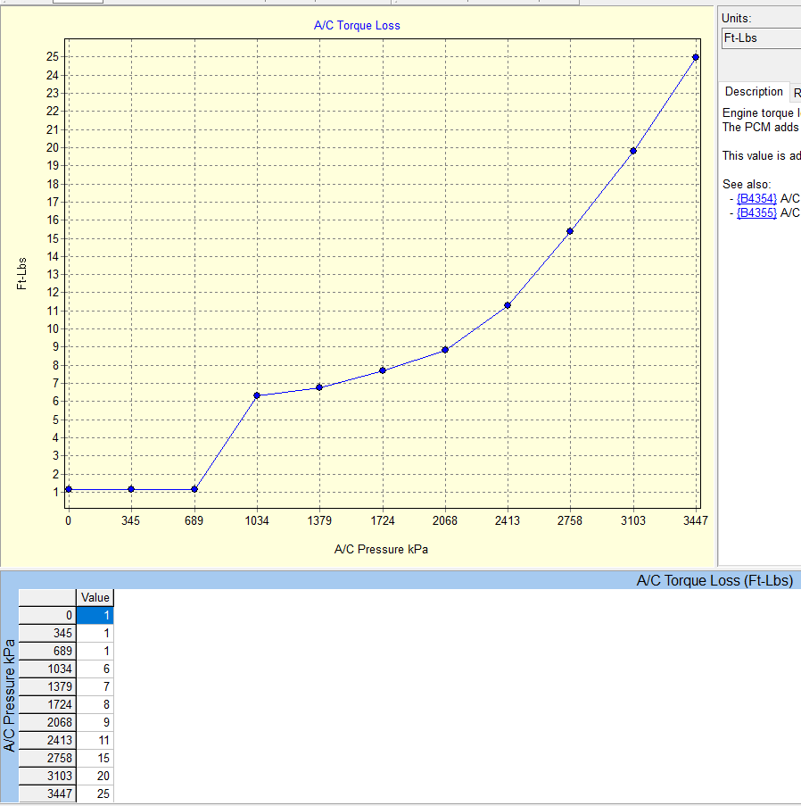

BTW the pcm has a table to model torque loss vs AC pressure, I've never logged AC pressure so I can't really speak to normal operating conditions for that. I believe it is an idle-specific table, so that the pcm can pre-emptively add airflow based on AC pressure so you don't get rev drop etc.

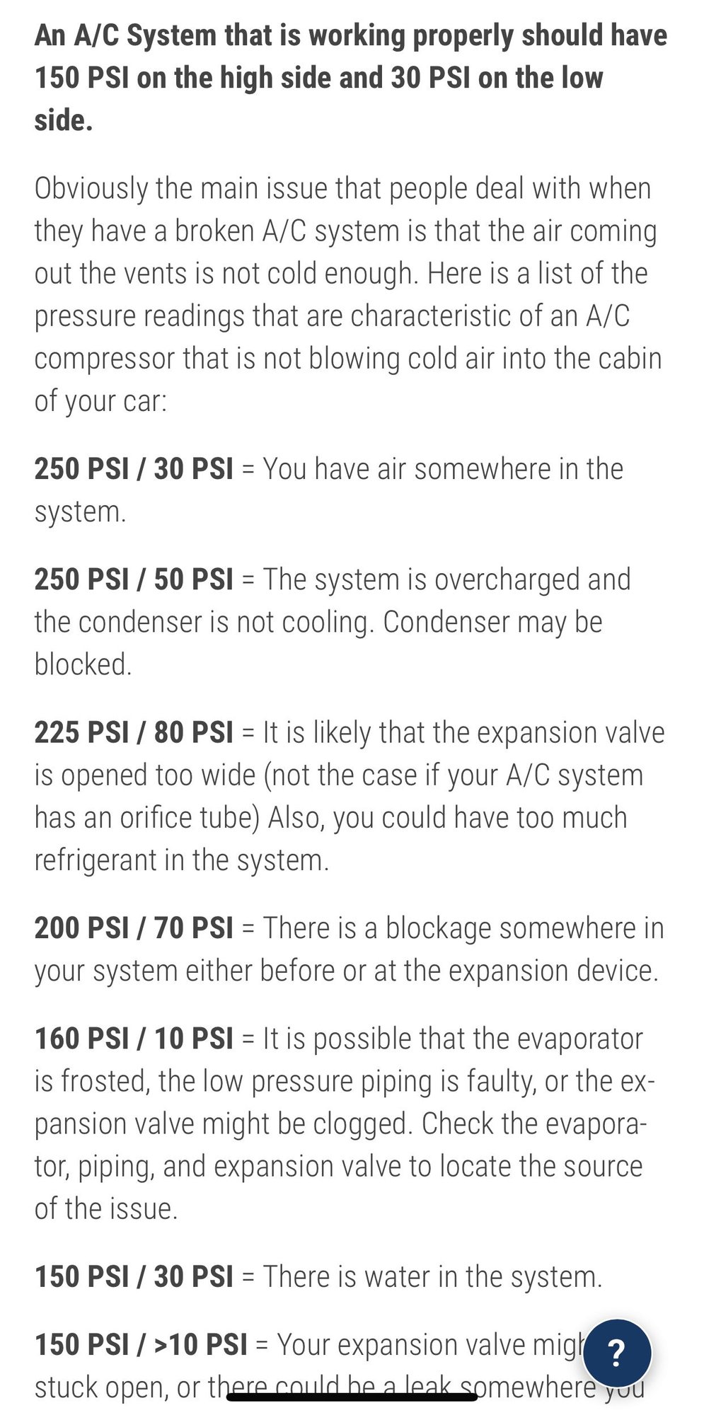

400-500 psi eh?
Last I known a a/c to actuate at is @ or about 27 psi on the low and shut off @ or about 150 on the high side ... Your psi values are much to high ....

Originally Posted by Speedy007
400-500 psi eh?
You must live in Alaska. On the North Slope.

Do I need to start datalogging AC pressure? lol

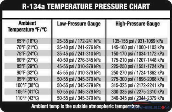

The service manual has a nice table of pressure vs ambient air temp that I referenced when I recharged my system. IIRC mine was jumping around a lot when I tested it but that's probably most applicable here.
Quality sucks, but I found this real quick googling.

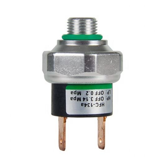

I looked around but I couldn't find the settings specific to the C5. All I was able to find was a generic R134a switch. 3.14 Mega Pascals = 455 psi. I'm pretty sure the C5 cutoff pressure is between 400 and 450 psi. I know it was 450 psi on the impalas.
To Why?
