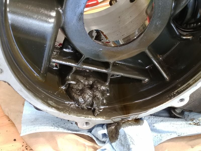

If you don't mind me asking, why are you considering a magnetic drain plug for the diff? The diff has a big magnet in it already to catch ferrous debris. If it is overloaded then it's time to disassemble and clean out the diff IMO.
For reference, my C5Z's diff's magnet was at its limit:
Mine was 4 times that much. That's what i had to do. The reason was where the cv go into the diff i had the shaft moving 1/2 inch side to and up and down. Tore it all apart. Spider and out shaft gear missing chunk. The ring and pinion had chunks missing also but left them. It still worked because the matraial was ground steel acting like the clutches.

I have a strong suspicion that a magnetic drain plug will hold substantially less debris than the internal magnet - but I do see your point. Though I wonder how often you change your diff fluid? It's not a very regular maintenance item for most people.
My clutch packs were toast - the breakaway torque was zero. I didn't know the magnet was so saturated, but if your diff's breakaway torque is zero it's time for a LSD rebuild anyways (and your magnet could be saturated too).

Check your LSD breakaway torque first. If it's low/zero, it's time to rebuild the LSD anyways.
