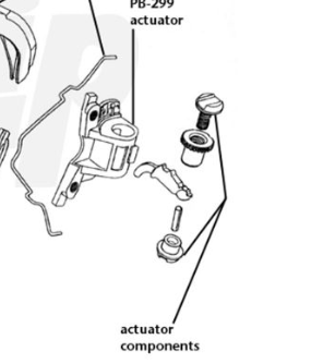

I been having issue with may Parking brake not engaging enough so took off the caliper/rotor and attempted to adjust the shoes(2x) still no major changes. So finally I took it apart again and the driver side emergency brake cable is not attached to anything(hook). After research I found that the lever for the emergency brake actuator is missing. However, I have been having trouble finding the part online for a c5 vette. ANY HELP WOULD BE APPRECIATED.
IM MISSING THE HOOK BUT I PROBABLY NEED THE ENTIRE ASSEMBLY

I’ve seen the parts before as part of a hardware kit, but now none of the kits I find listed includes them. Zip sold full kits with shoes, hardware, and the levers - that PB 299 in your graphic - but no longer carries that number, though the still depict it. I suspect you’re stuck with used. Try Vettenuts or another breaker on the for sale threads.
