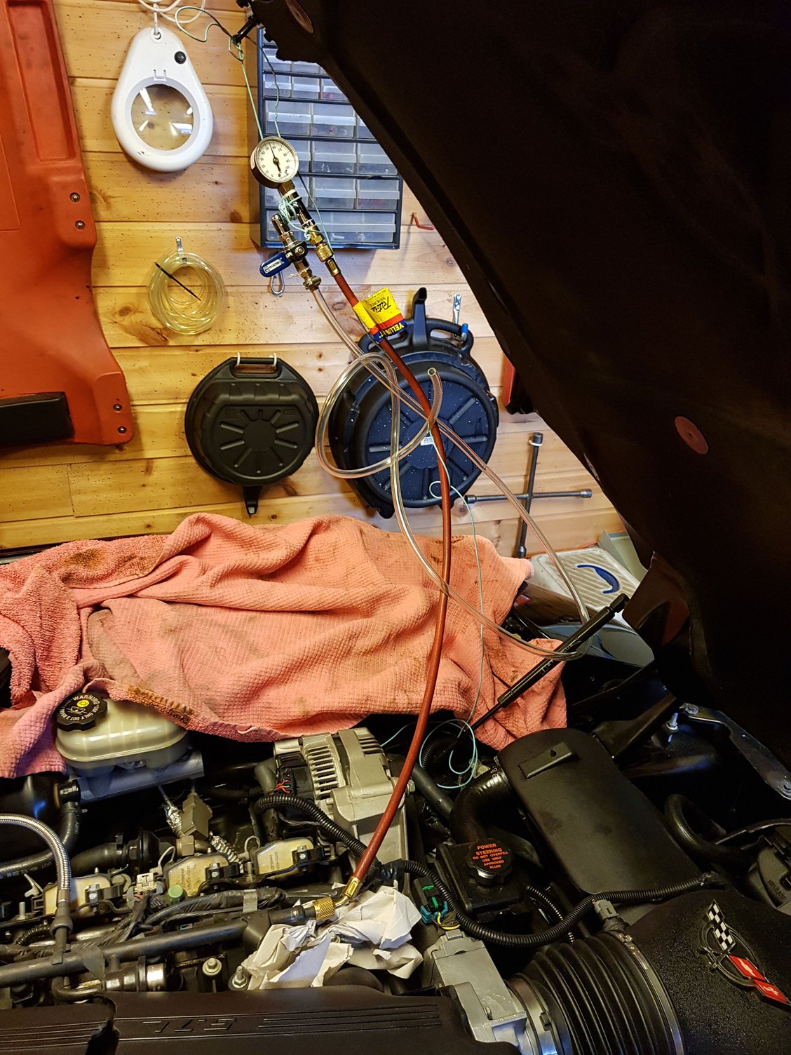

This is how I connect my gauge to the fuel rail
thanks. I don’t have those tools. But looks great.
