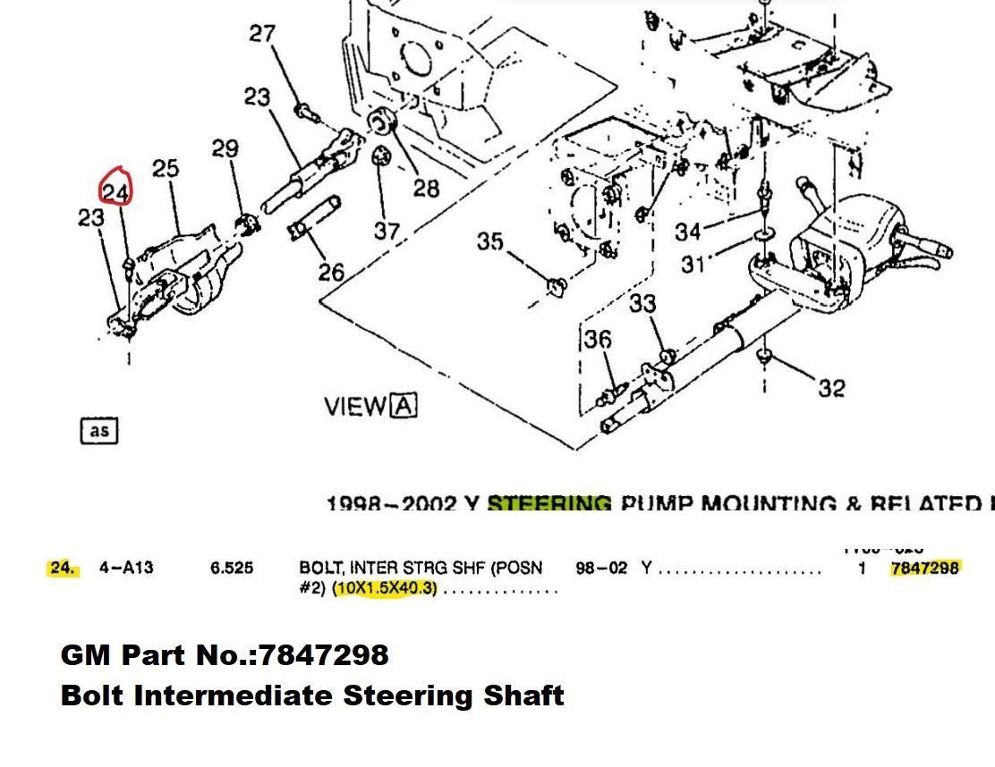

I lost a bunch of bolts in anger when I took my car apart last. What size or part number is the bolt that connects the steering rack to the steering shaft? Its a C shaped housing that slides over the shaft. I searched but couldn't find any size.

Here ya go...P/N 7847298

I lost mine as well. I have a 1998, and I have a 10 1.5 threaded bolt to test fit, but it did not fit.

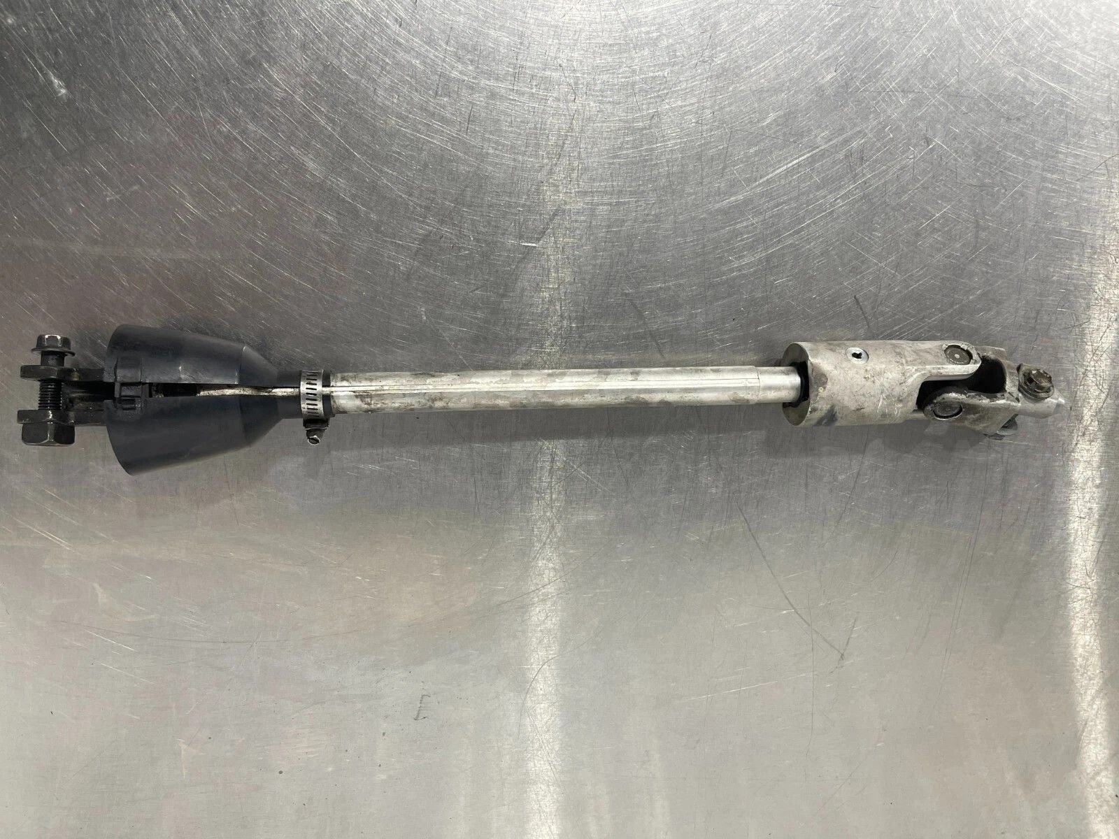

I also don't remember my bolt being nearly 40.3mm if I'm reading that correctly. I don't see a hole through the shaft to support such a long bolt. It seems like it's merely friction-fit with the one short bolt, as that's what I remember taking off.
In fairness, you did loose the hardware to your car....so perhaps your memory is not relevant.
The bolt is not that long at 1.59" .....

So I see it locks around instead of a friction-fit like I thought. Thanks. And there's a corresponding nut on the other side. In my defense, it is hard to reach, so I couldn't see it very well, but against myself, I should've kept track of it... Thank you anyway.
