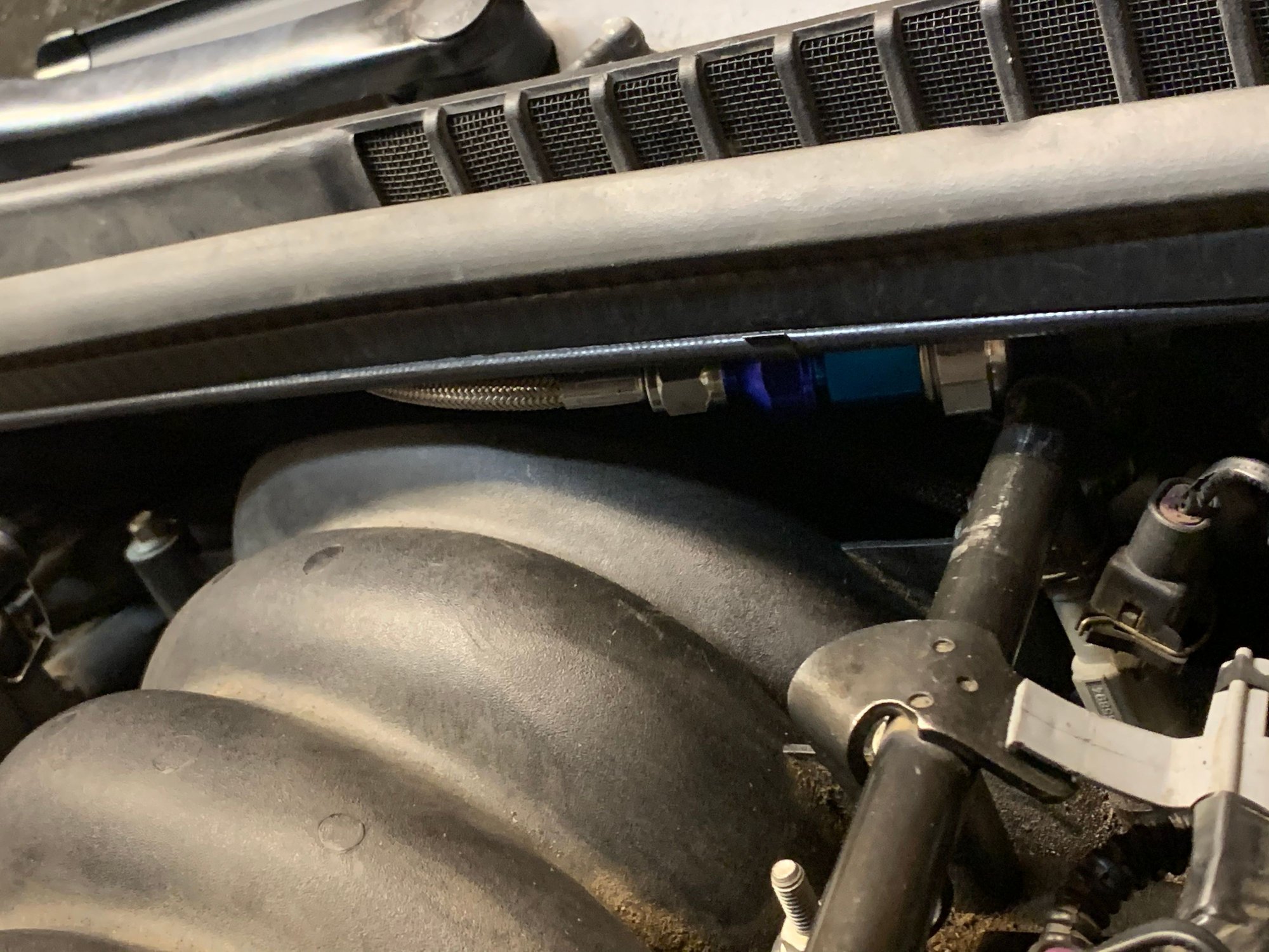

Originally Posted by Secret237
... but I wish I had done the relocation option.
I did mine today

Originally Posted by jdmvette
I did mine today
I hope it went well. Can you please send the info on the relocation kit you used?
Also, did you do anything with your vacuum lines behind the manifold?
