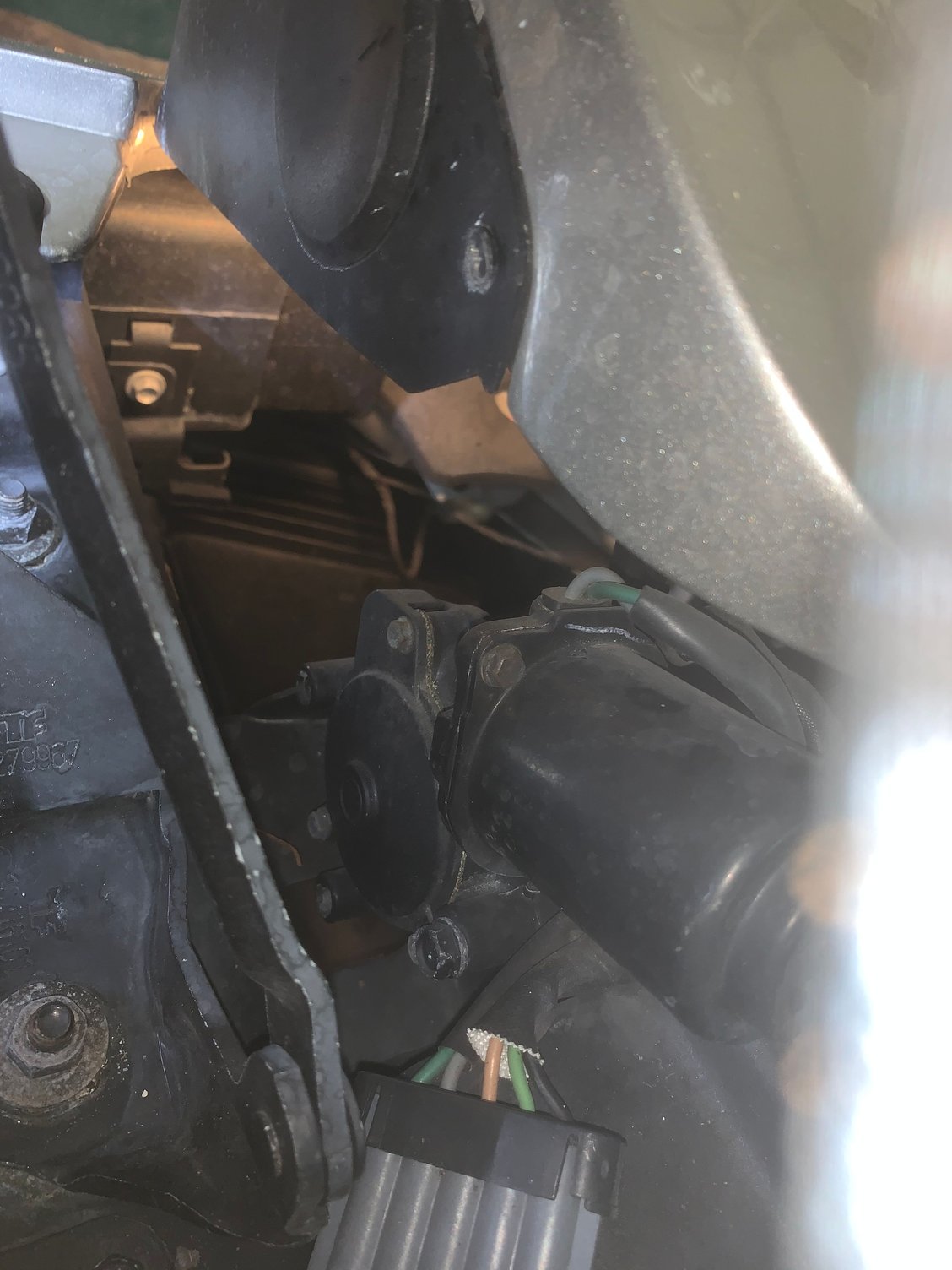

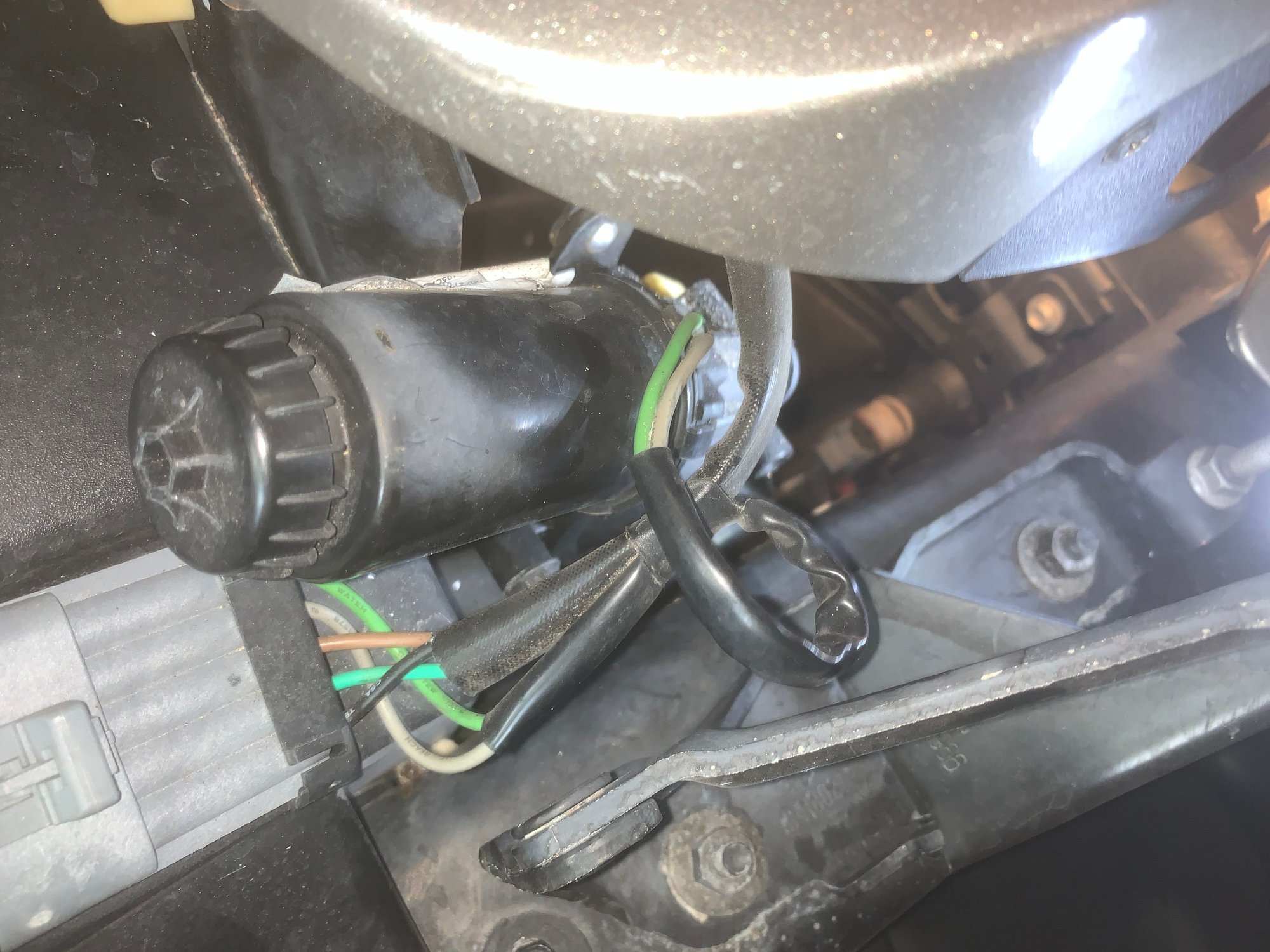

The motor assemblies look slightly different from each other. The driver side cover over the large gear has no screws while the passenger side does. Is this difference only because I can see the screws or has the driver been changed before?

There are 2 type of headlight motors. Your car is a '99 and if it has has one of each type, it has to be because one of the original motors was replaced with the newer model. They are easy to differentiate (see pictures below):
  • The 97 to early 2000 motor assembly is all aluminum and has a removable side cover that is held on with 3 machine screws.
  • The late 2000 to 2004 headlight motor assemblies are plastic and the side cover is glued on.
In any case, early motors (aluminum assembly) and late motors (plastic assembly) are totally interchangeable. You can install one in place of the other without any worries.
Make sure you get the right repair kit for your motor.
