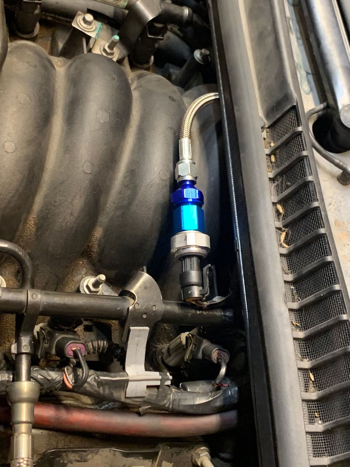

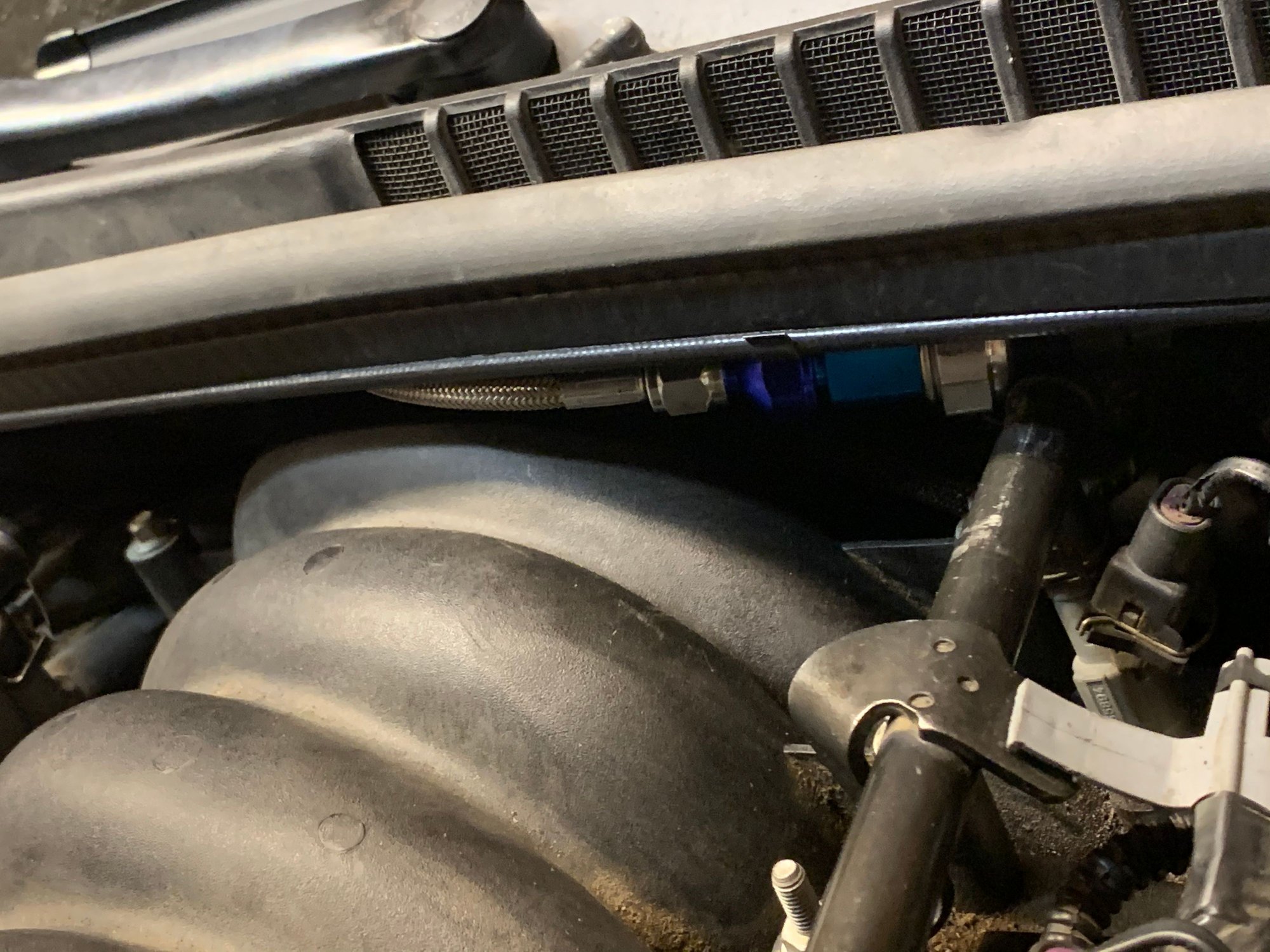

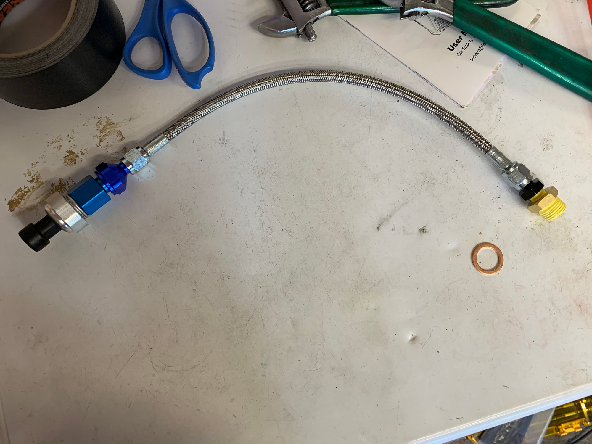

Do it once with a relocation kit and never worry about it again
Does it just lay there or is it mounted down?
I did this also, a tad expensive but now if the sensor goes bad, 1 minute change out.
It's just tucked in. It's a snug area
