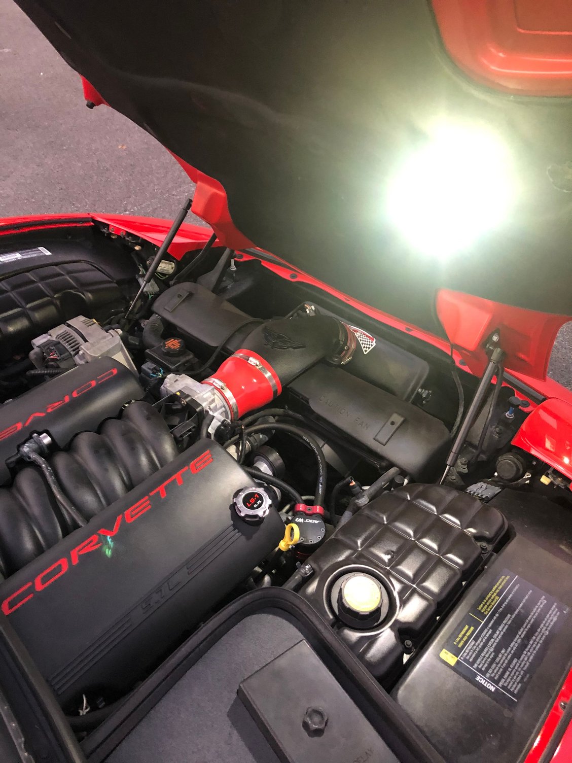

I’m in the process of switching all of the bulbs on my C5 over to LED’s. It’s all LED now, except the tail lights, which will be soon.
I’m having a slight problem with the under hood light. It seems when I open the hood it burns very dim. But when I start the car, it’s very bright as it should be.
The bulb doesn’t have a good tight fit like the stock bulb did. I’ve seen posts where this is a common problem with these LED’s. I can tap the lens and it’ll flicker a little. What can I do to make it a little tighter connection? Any other LED’s for the hood light you guys recommend??

You need to install a resistor to adjust the voltage. I had the same problem: open the hood and the light would be dim. Someone suggested that if I opened a door or flipped open the visor mirror lights, that it would brighten up (they're on the same fuse). Sure enough, the light immediately became bright.
