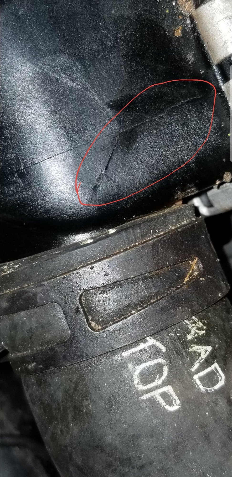

It is amazing how our factory radiators seem to crack in the exact same way. Clearly this unit is failing to maintain pressure and needs to be replaced; an attempt to repair it will likely be temporary at best and catastrophic at worst.
I am leaning heavily towards an upgrade; if you agree or disagree please chime in. My engine is currently stock aside from LT headers, it will get power-adders later when it is no longer my DD, so I figure upgrading now is not a bad idea and I can't imagine a bit of extra cooling ability being a bad thing.
This is one I had in mind as it appears to be a direct replacement. Car is a manual, so the AT cooler portion I suppose is not needed?
