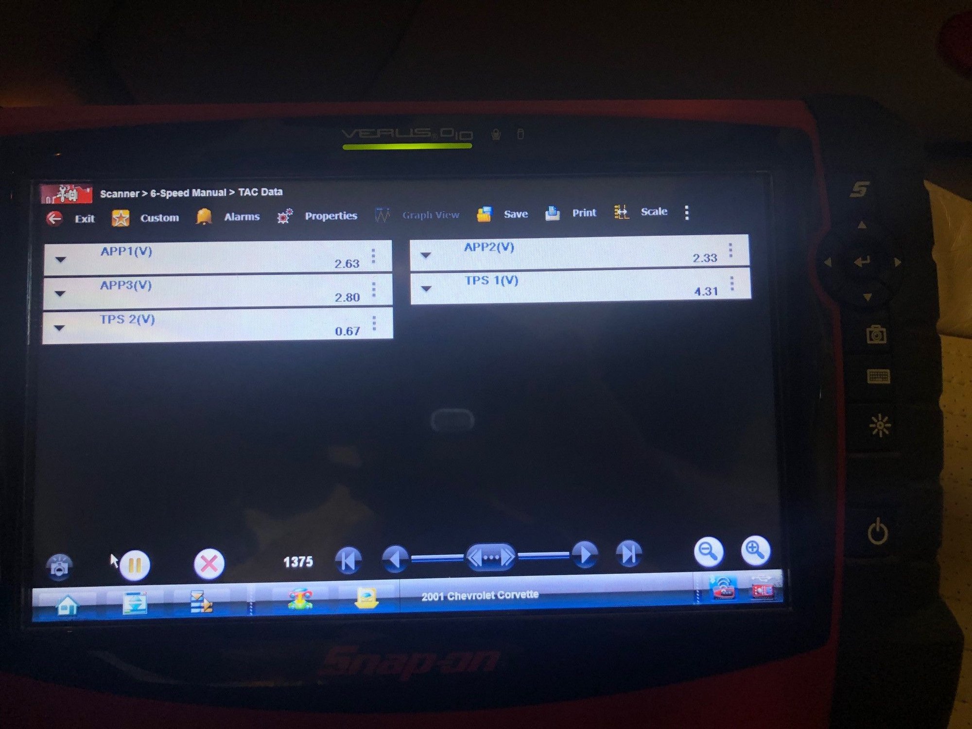

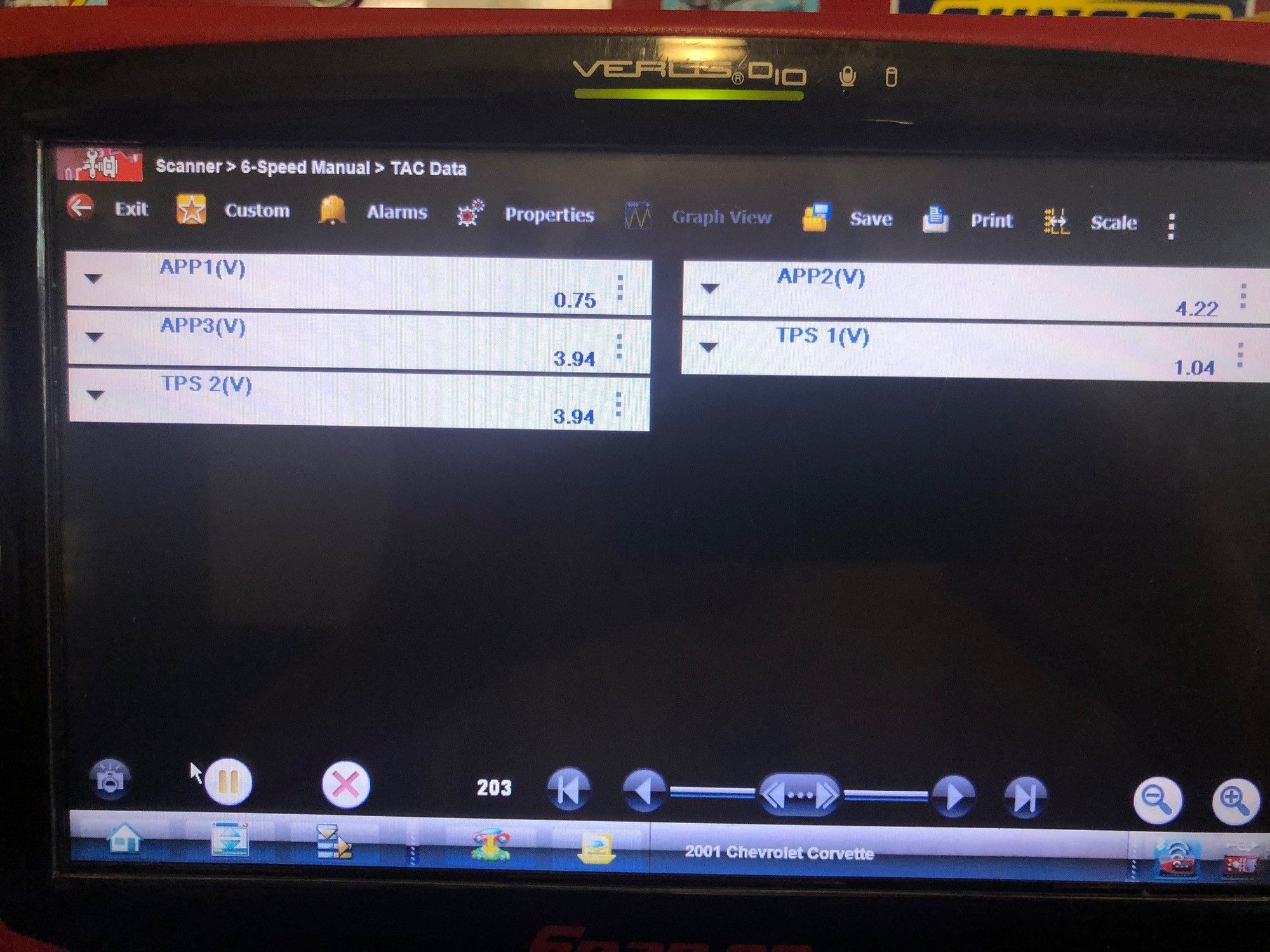

There are LOTS of YouTube videos where you can pick up this labscope info. Secondary ignition has a not to bad learning curve and in cylinder pressure transducer analysis is pretty steep...when you look at a lot of good signals you will know what bad is !!...is the P1220 and 1221 current or history ??...these pics below are what my APP/TPS looks like at idle and WOT. Your voltages should be pretty close.

The pcm codes are both current and history. I won't be able to get the car to the shop until later this week possibly to put the scanner on it. So I back probed with my dvom. These are my results: Key on engine off
Blue wire Tp sensor signal 1 : Idle 1.337 Volts Wot 4.46 Volts
Pink wire Tp sensor signal 2 : Idle 3.70 Volts Wot 0.565 Volts
Dark blue wire App signal 1 : Idle 0.70 Volts Wot 2.74 Volts
Light blue wire App signal 2 : Idle 4.35 Volts Wot 2.30 Volts
Dark green wire App signal 3 : Idle 4.03 Volts Wot 2.80 Volts
