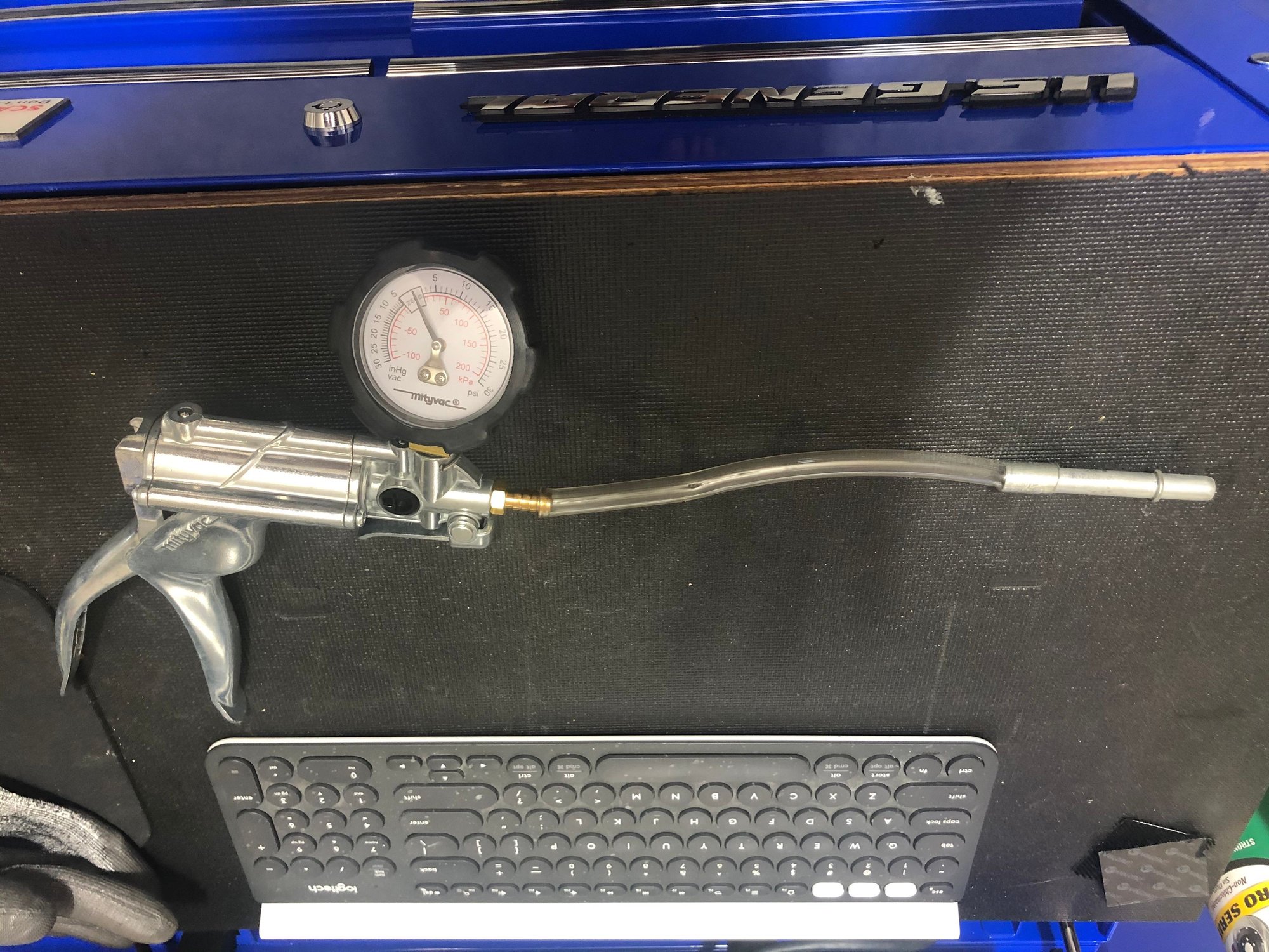

I hooked up a fuel pressure gauge to my rail and the pressure drops steadily to 0 as soon as I shut the car off, the injectors, fuel regulator and pump are all new. This is really confusing to me because the car will turn on first thing in the morning even though it has 0 pressure built up. Could this be the check valve in the rear?
You can’t assume all the new parts you changed are good unless you check each one...as far as the check valve the easiest way to diagnose is with a Mityvac and a male fuel inlet fitting...pump in around 15 psi and see if it holds pressure for around 10 seconds...
this is how mine is set up !!
