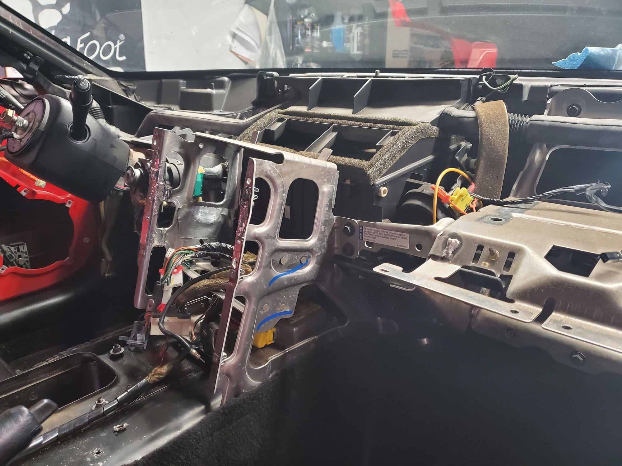

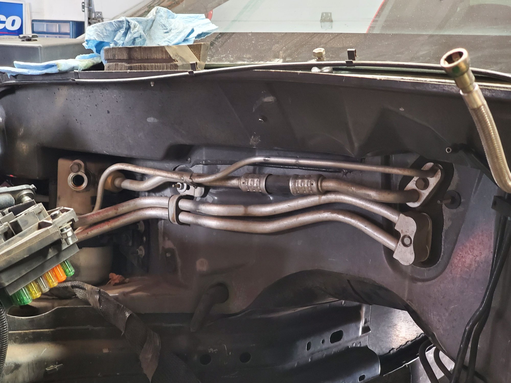

If it is the evaporator that has the leak, it is not going to be fun to replace. The lines that go through the firewall are behind the engine and those would be the easy part of the replacement.
The complete dash has to come out of the car along with the center stack to get access to the heater/AC core.
Here are a couple of pictures to give you an idea of what I described.
Gary
Firewall view from drivers side
view from passenger side
Gary
Thx Gary. I thought it would be a HUGE PITA. This is probably one of the hardest jobs on a C5, isn't it?
