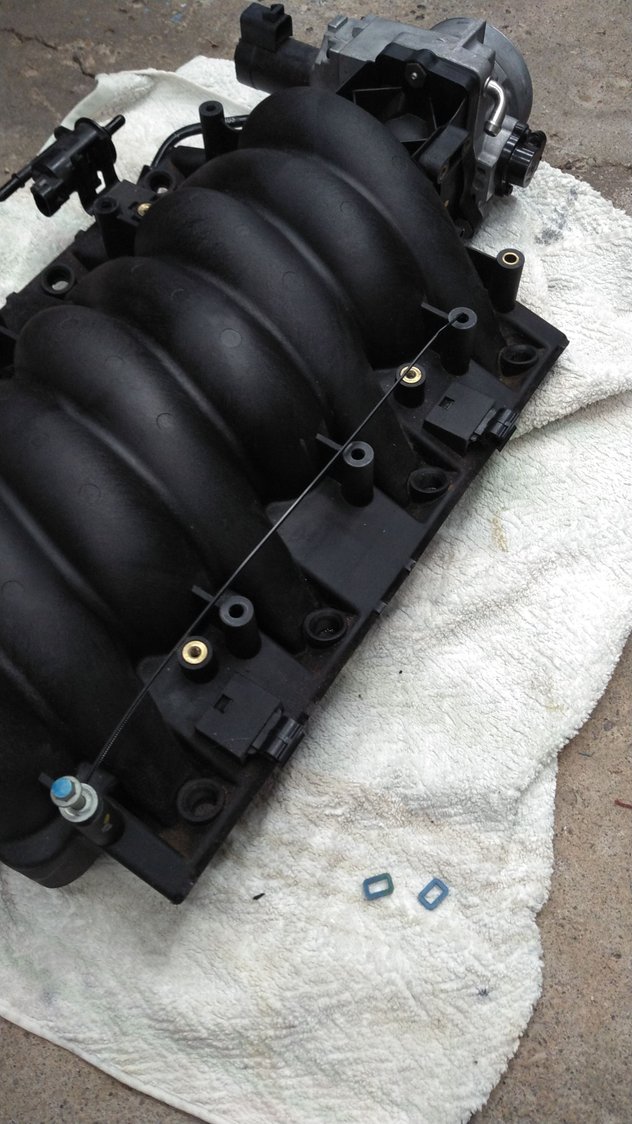

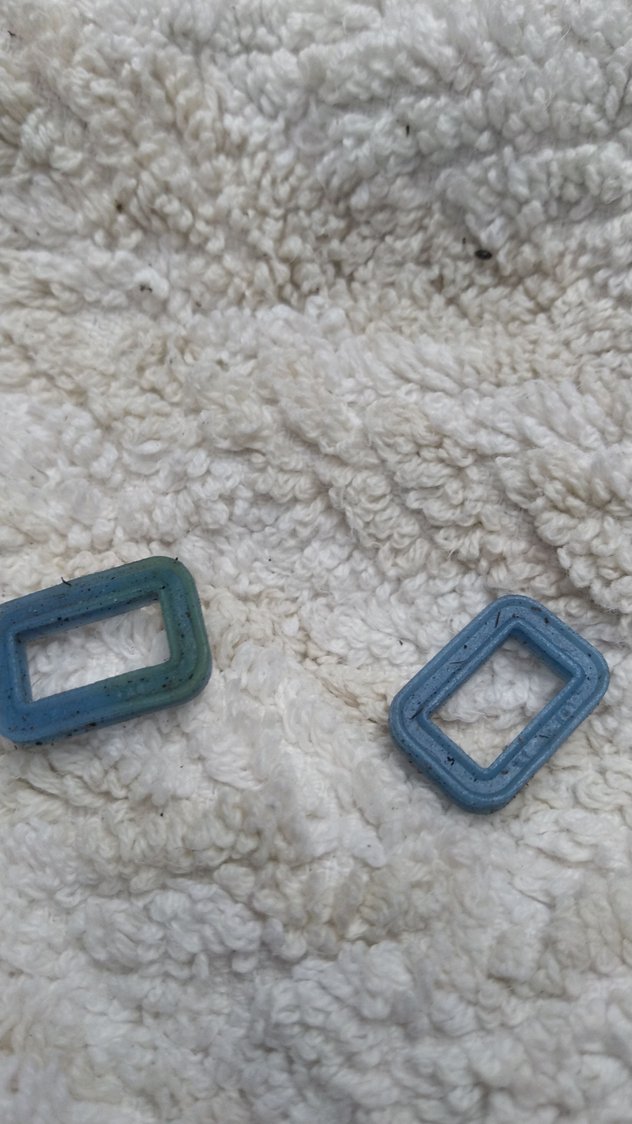

I just took my intake manifold off and when I finally got it off I found these two blue rectangular silicone things sitting on the valley. Does anyone know what they are, where they came from or how many total there are supposed to be? Im worried that more could have fallen into the engine.

They looked like your fuel injector electrical connector seals...

Thats exactly what they look like..

The above posts are 100% correct. Look in each connector on the harness. If more than 2 are missing, you need to replace the missing ones. They seal weather out from corroding the connection from the harness to the injector.

Ok peeps, I found all 8 of them. You all are amazing thank you. My worry is at ease!
