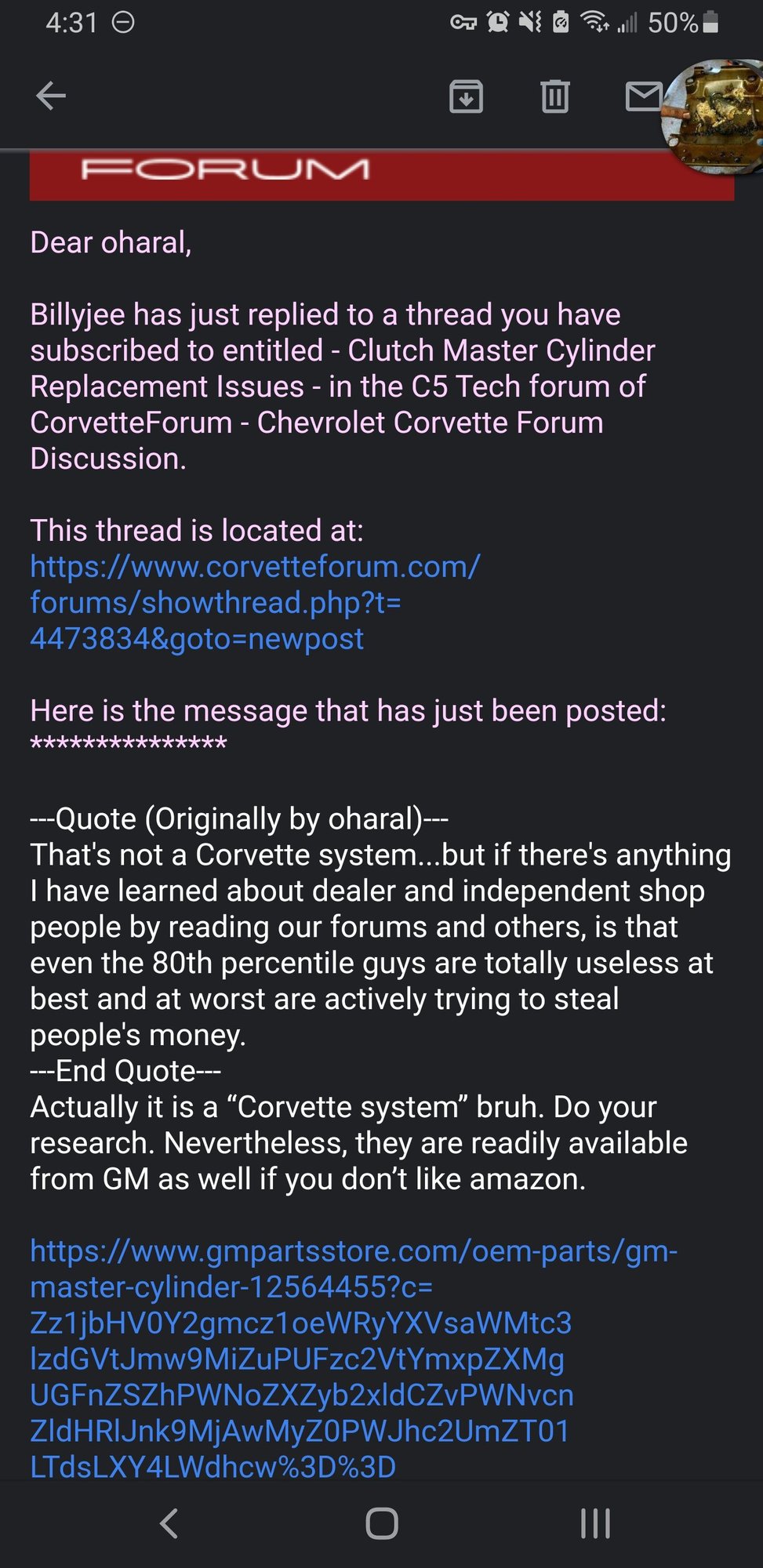

To Clutch Master Cylinder Replacement Issues

Old Dec 7, 2020 | 04:33 PM
oharal's Avatar
oharal
Joined: Mar 2015
Posts: 1,421
Likes: 302
From: CSRA, SC
Originally Posted by Billyjee
Did you already forget what you wrote first, "Bruh?"
Old Dec 7, 2020 | 04:39 PM
oharal's Avatar
oharal
Joined: Mar 2015
Posts: 1,421
Likes: 302
From: CSRA, SC
And I said "nice save" surely it makes sense...
The forum is a wealth of information and great people. I see you've been a member for 3 weeks. Welcome to the forum. You'll get the most value out of it if you don't tell people to "do their research bruh" on stuff as they might have years of experience already...
