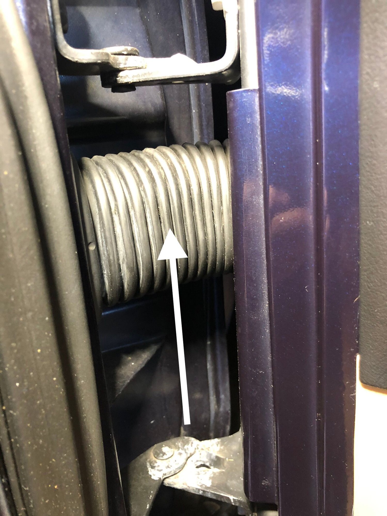

I am a first time Corvette owner (2002 Base Coupe). The driver's side door panel "intermittently" goes dead. Windows don't work, memory seats don't work and neither do the door locks.
I've already replaced the four ground splices in the engine compartment, however there is a ground splice by the hood release, that grounds the above mentioned circuits.
Looks like I need to remove the door sill trim?? Can I do this without breaking anything?? Any special tool that I need??
Thanks all!!

You might try cleaning the contacts in the 2 connectors between the door and the body. Access them by pulling the rubber boot back. When these get corroded you will get all kinds of error messages and electrical failures. Its quick, easy and cheap to do. I have had to do this several times over the years.

The DDM (Driver Door Module) is located behind the door panel and yes there is a connector inside that rubber boot...picture below !!
