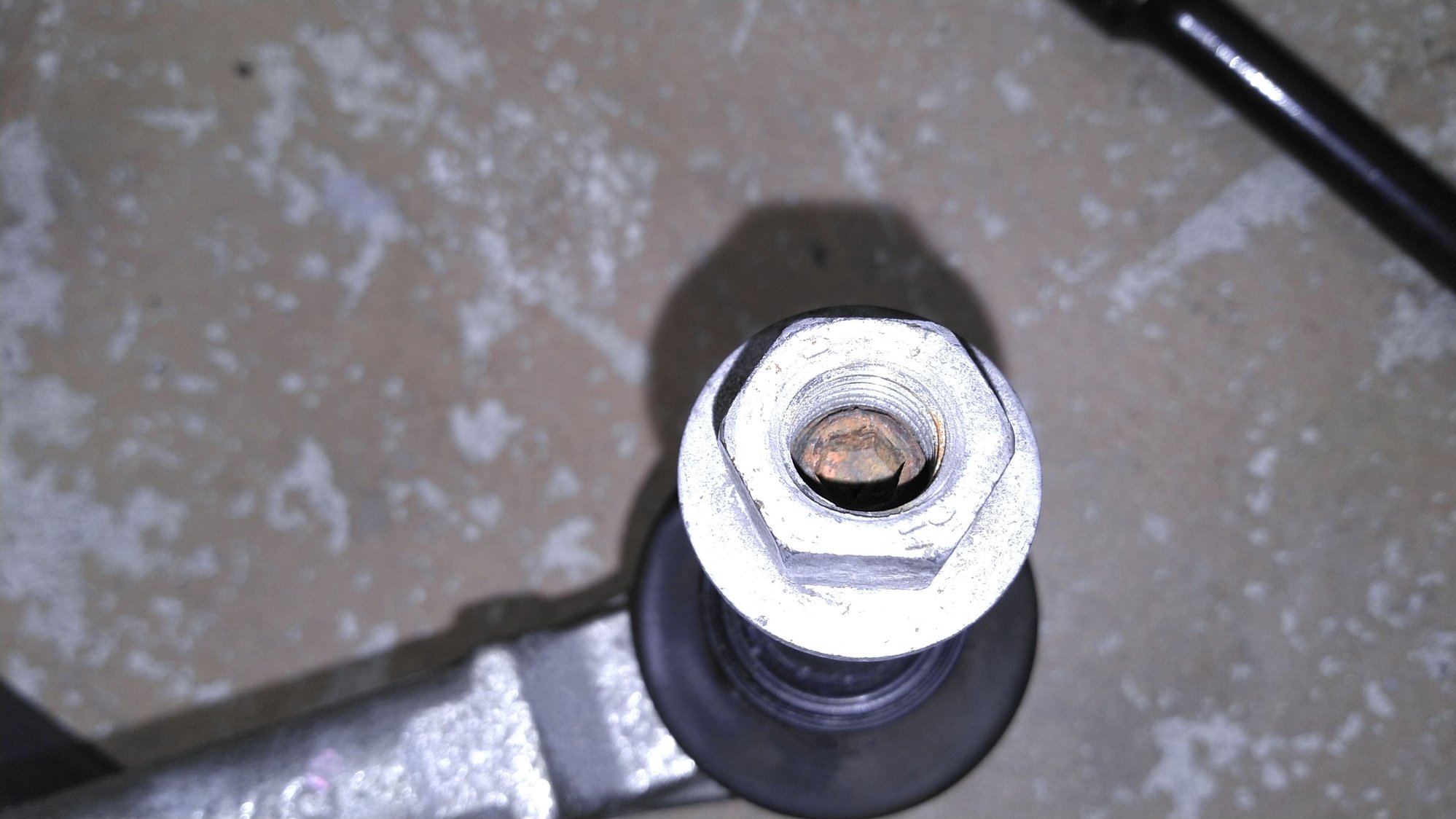

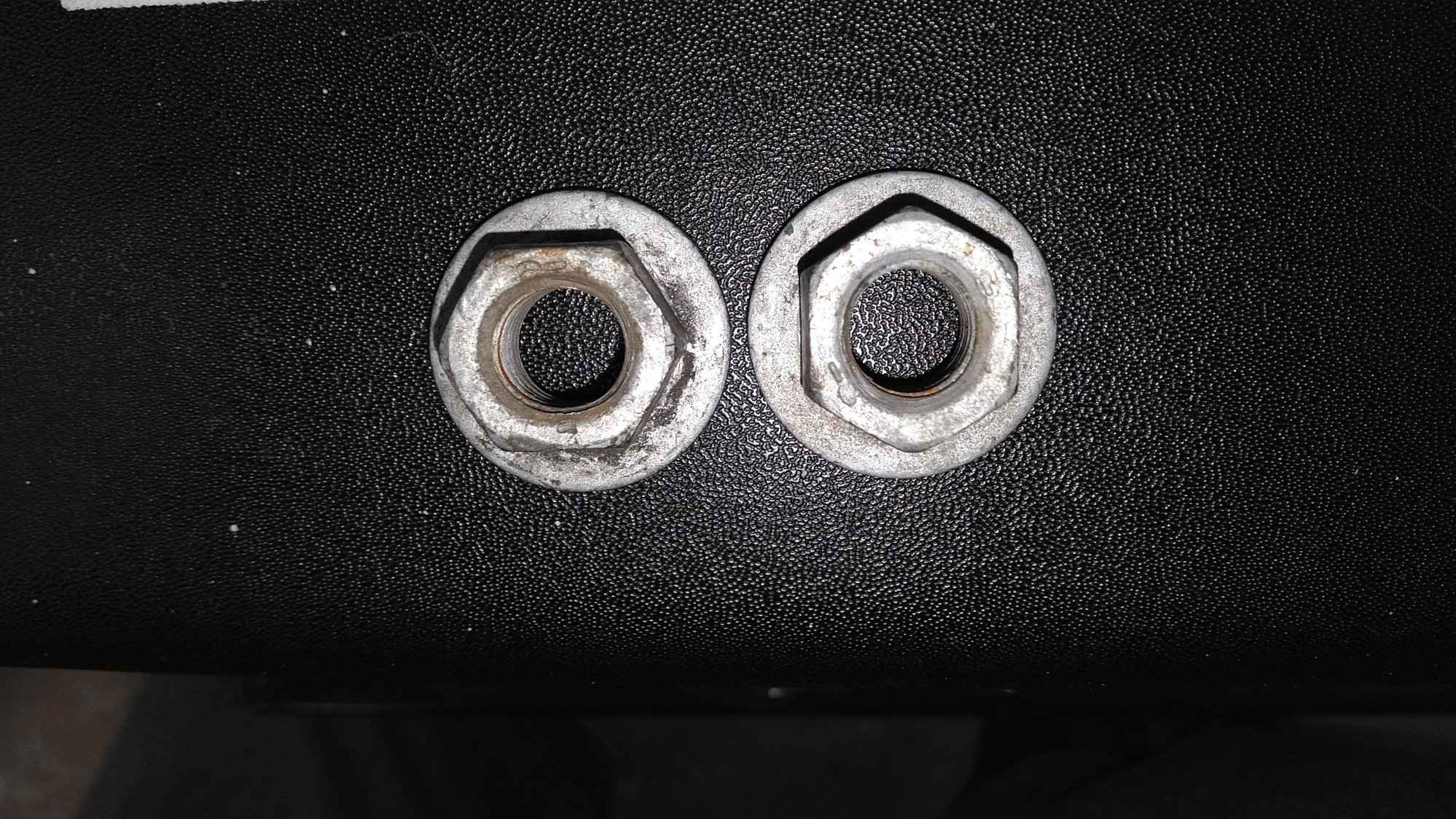

1). Are the oblong nuts that secure the tierod ends to the spindle reusable or are they the kind that crush into shape when torqued and need to be replaced? I'll attach a picture.

#1 I re-used them

1. I reused mine and can't find anything in the documentation I have that says to replace them.

The nuts can be reused. Although the cradle nuts are supposed to be replaced according to the FSM.

Thank you all. And thank you feeder, I ordered 4 new nuts. Will torque to 81 ft-lbs
