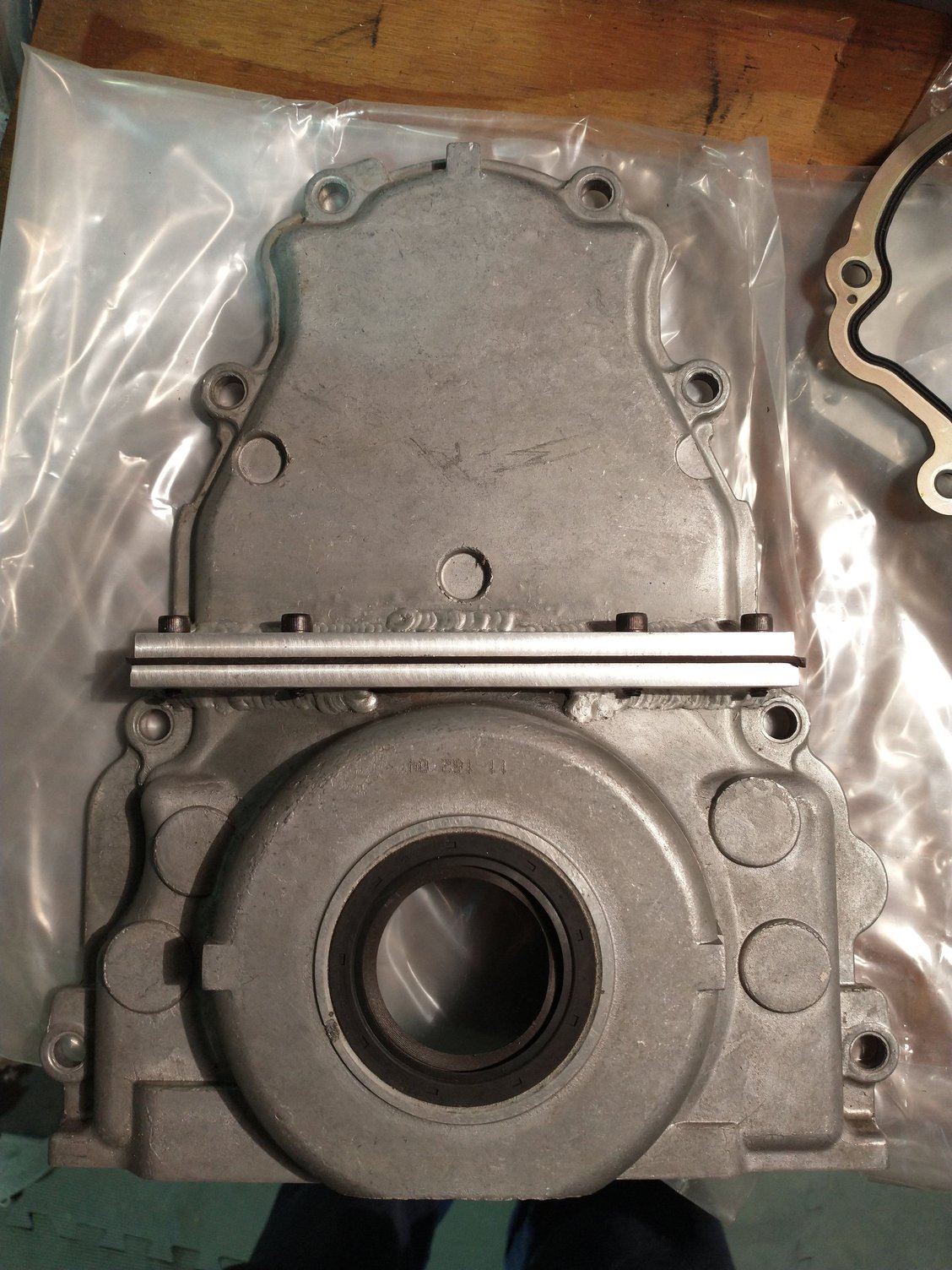

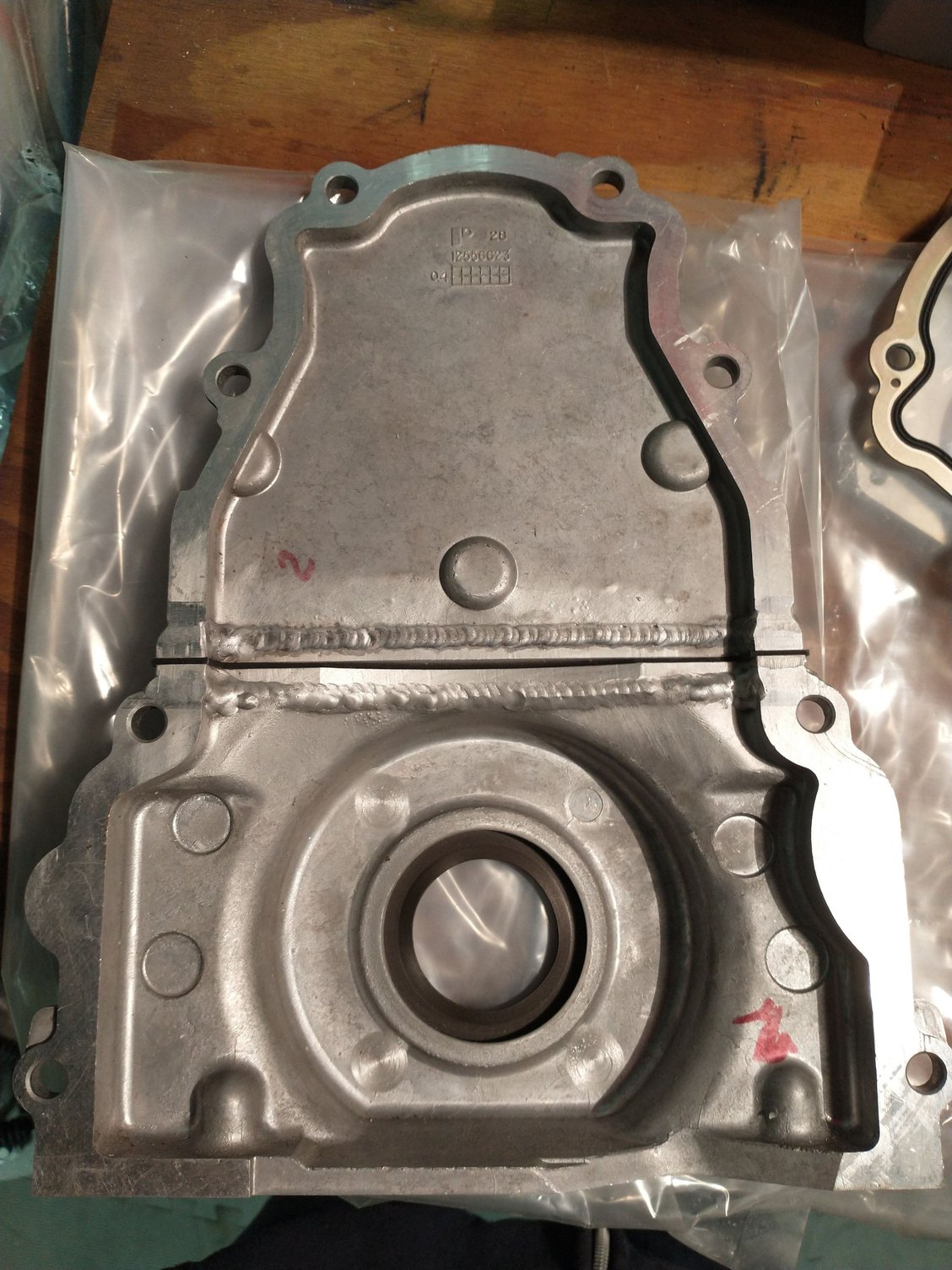

Default I have this one
I'm going to use this on my car, bought it a few years ago.

That looks like what I'm talkin' about!! Yes, nice work. I think that looks good, and you've restored most all of the vertical structural integrity. OP, this might work out better than the commercially available ones, and would probably cost less!! BTW-What are you using for a gasket between the top and bottom pieces? Or are you simply using a thin coat after silicone?
