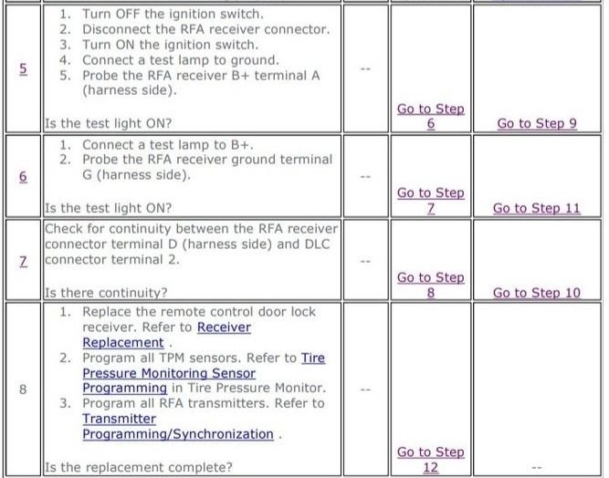

v6turbo87, While I tend to agree it is unclear what actually worked and did not work prior to the BCM / LCM5 replacement / mod. The BCM appeared to be causing a significant current draw and was taking down a fully charged battery in less than 1 hour. Since I have the RFA removed, checking the wiring ground, power and other wireswould be an easy way to rule the RFA in or out. Just need to know what to expect on each wire... Thanks, dofdear

Originally Posted by dofdear
Goose,
I've located the RFA and removed it. The print you provided is fussy. What should I expect on each of the 3 wires at the RFA connector?
Also, If I replace the RFA is there any matching with a scan tool required or will the system automatically recognize and marry up?
Thanks, dofdear
If you double click on the above schematic, it should open in a new window, from there you can enlarge the photo (and move the photo around) to read the schematic and troubleshooting procedures.
Orang wire> 12volts power in to RFA
Black/White Stripe wire> Ground source (wire) to RFA
Pink Wire wire> Serial Data Line> DO NOT PUT POWER TO THIS WIRE.
Goose,
Thanks, dofdear
The orange wire is 12V or battery, the black/white wire is ground and the pink is the serial bus. Check the power and ground wires first. If they check out then you have to track down the serial bus issue.
The module is plug and play and the training and fobs should simply work once it's connected and functional. There is no BCM programmed required or any other programming required to make this work. On a 98 there isn't even an option to program the TPMS in the BCM. That option was added when the Z06's began to ship because they came without TPM sensors.
Heck, you can even install the newer module and use the newer and cheaper fobs and TPMs in the car without doing anything extra.
