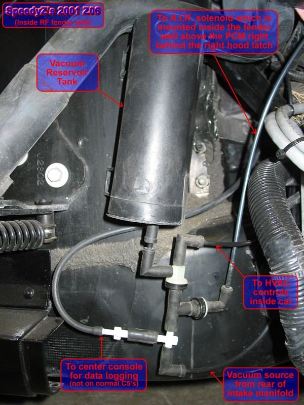

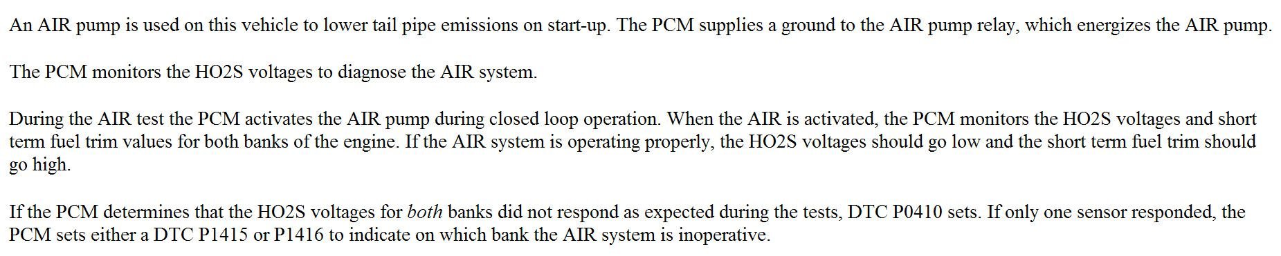

Here is some info on how this system works .
As C5 Diag mention several parts can go wrong , but P0410 indicate that none of the front O2 sensor get any air from the pump indicating a pump /solonoid problem .
If you had access to a bidirectional scanner like Tech2 you can manually force on solonoid and pump and verify which component failing .

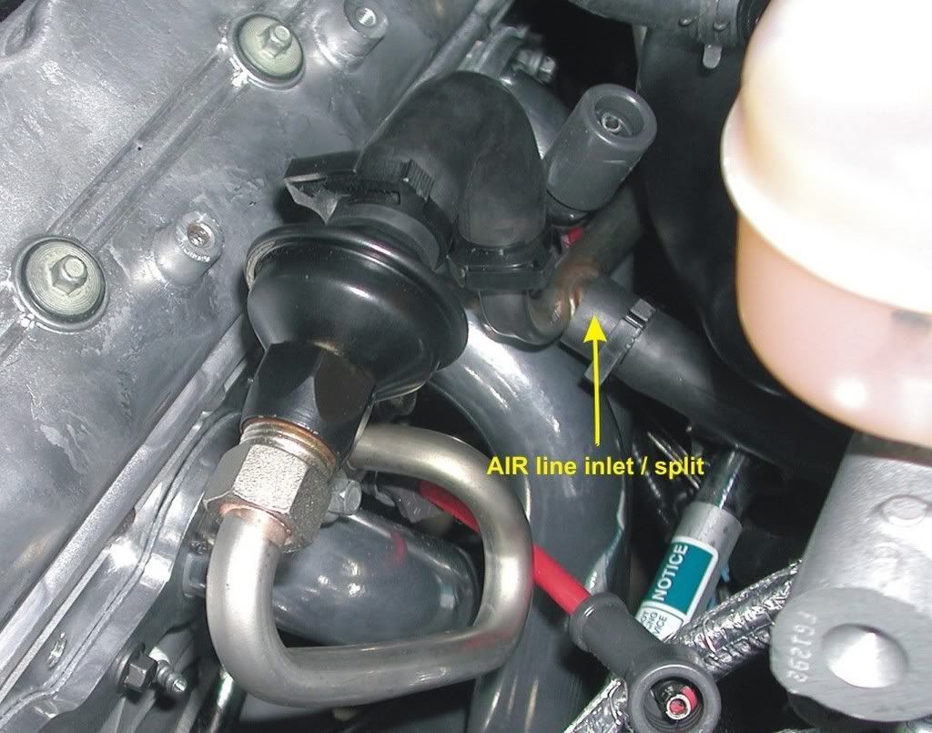

Pictures below show the location of the solonoid (passenger side) and the pump and shut off valve ( driver side) , check tubings for damages ,
If you are familiar with how relays works it is possible to bypassthese relays and check if air sol valve and air pump starts

The AC hose is leading vacuum through the air solonoid along the front bumper and open the Diverter Valve allowing airpump to feed air to both checkvalves shown in the photoes .
The vacuum is sourced from rear of the intake manifoil .

Okay so I think I get it now, the hose I am missing applies a vaccume to the output of the air pump that allows the air to flow through when a vaccum is applied.
I will buy a long tube online and try to get it hooked up. I just need to figure out how to get to the solenoid now, it must be behind some stuff near the passenger battery from what you guys have said but I wasn't able to locate it without removing stuff yet.
