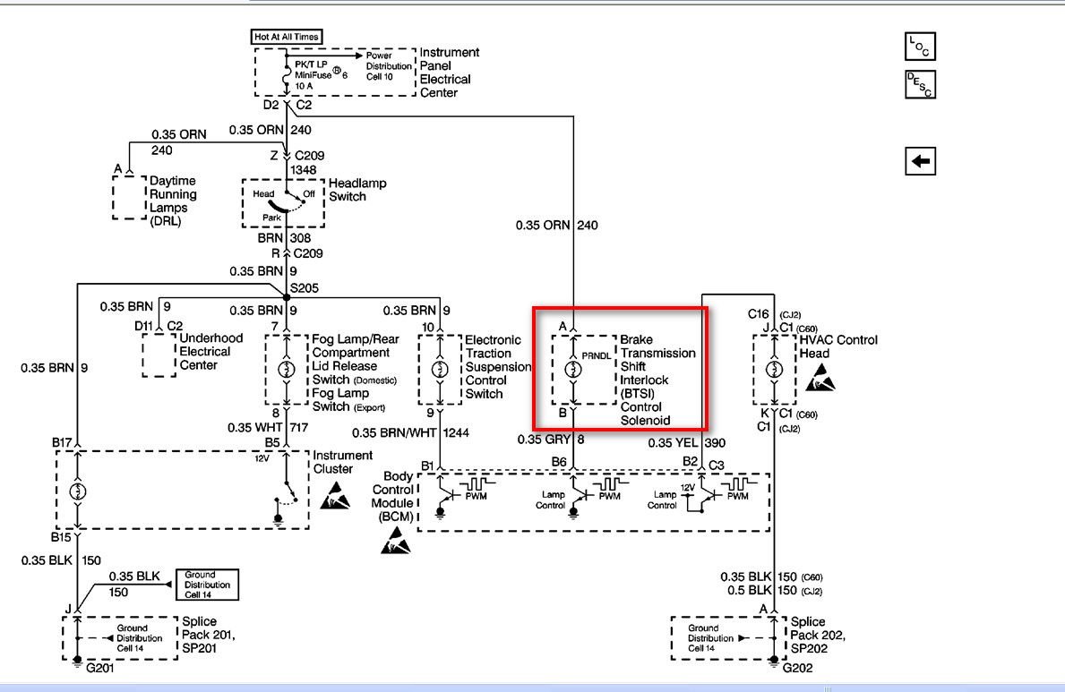

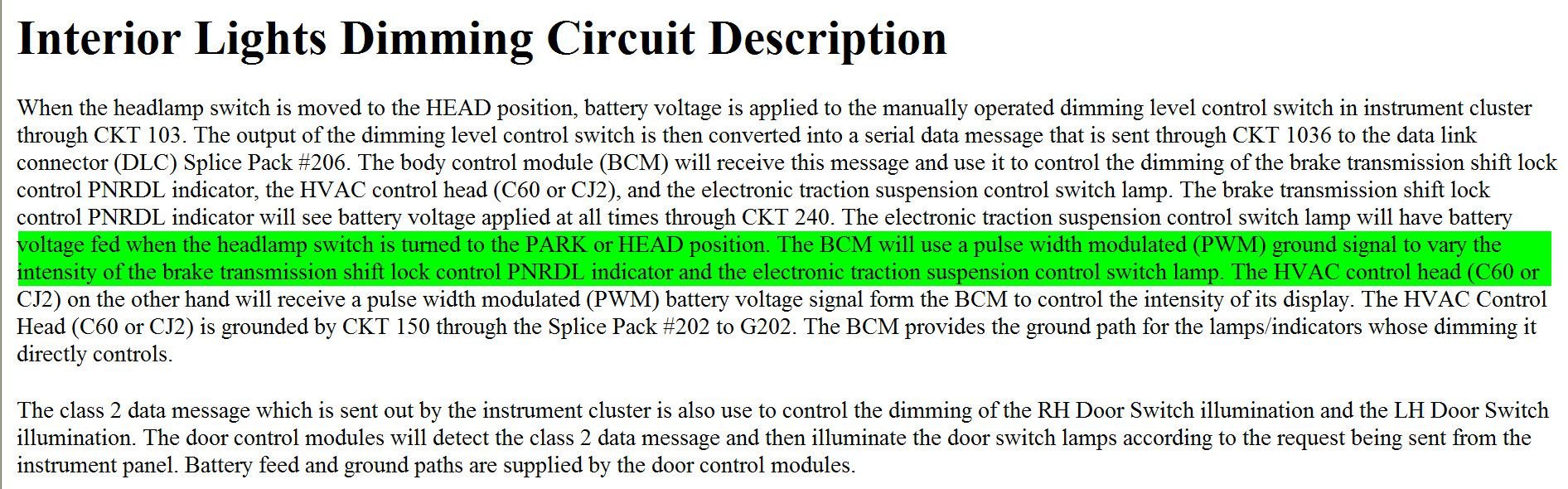

The gear selector light(dimming) is controlled by the BodyControl Module .
The BCM is partially grounding the light bulb by using pulse width modulation in order to achieve the dimming.
Are you able to dim this light using the dimming **** in the cluster ?

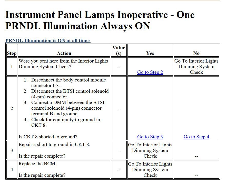

Seems like you have a short to ground somewhere on the B side of the bulb , maybe internally in the BCM .
Here is the Chevy procedure when the PRNDL is always ON .
Try to check out number 2 and 3 in this procedure

Pull connector C3 out of the BCM. If the lights go out then it's the BCM, otherwise there is a short on the grey wire from the lights to the BCM.
