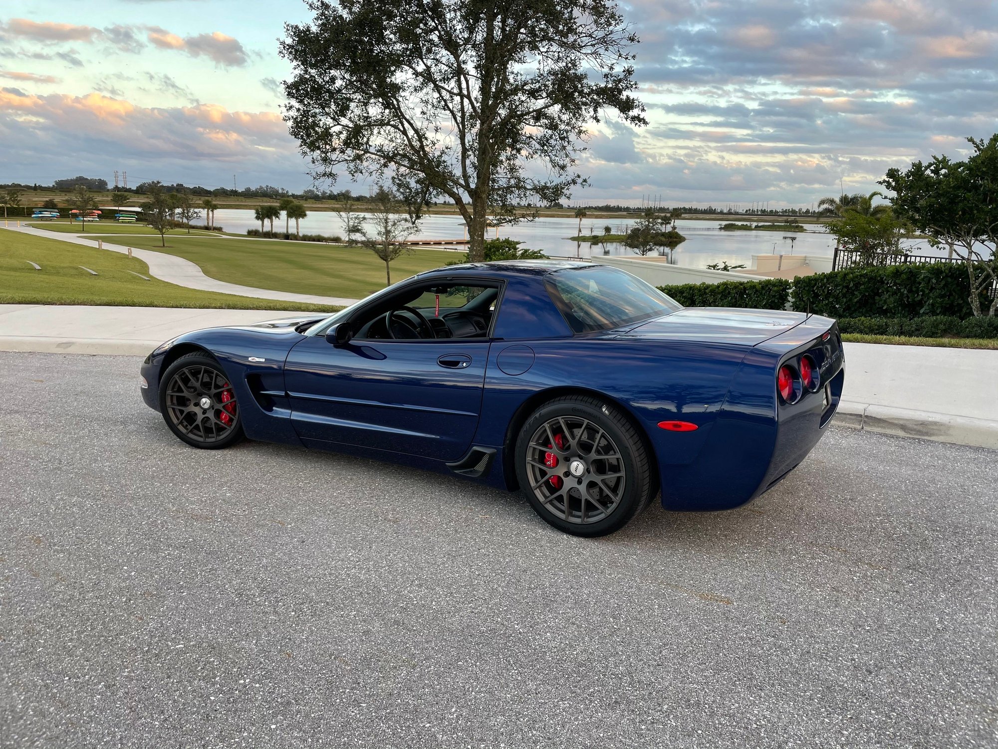

It was also a concern of mine when I bought my Z16. I believe it was also an issue in late 2003 as well.
https://www.corvetteforum.com/forums...read-this.html
Good luck in your search, I have a 26k mile Z16 and love it. Just an awesome Z06!
