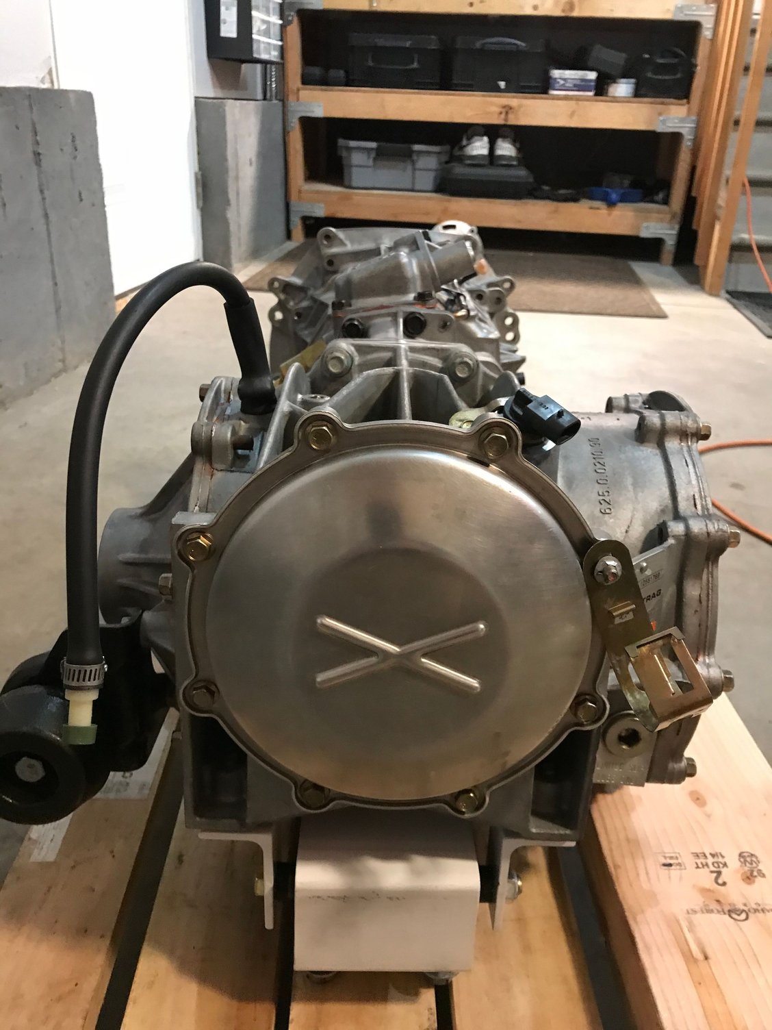

Those vents can sometimes get stuck in the closed position. I removed mine with the exception of the base that is pressed into the case. I then attached a hose using a worm clamp with a toggle valve on the other end. I plan to tie this up once I put my car back together.
