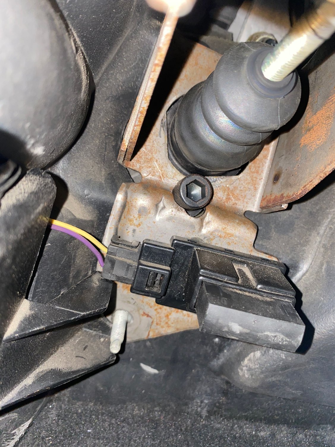

It did come with a sticker with two stars on it for drilling depending on the model of your application....just saying what I had to do to make it fit right ...if I recall correctly one start was in the center and one was near the upper left I used the center point don’t remember the bit size I used but I’ll try to get you a picture after I’m done changing the oil out today sometime .....so unhave something to go by at least. just be careful adjusting it after u can easily disrupt your lower back leaning over the seat trust me .....

Decided to get the picture before I left it for the oil change ....
To tick master cyl hmm
