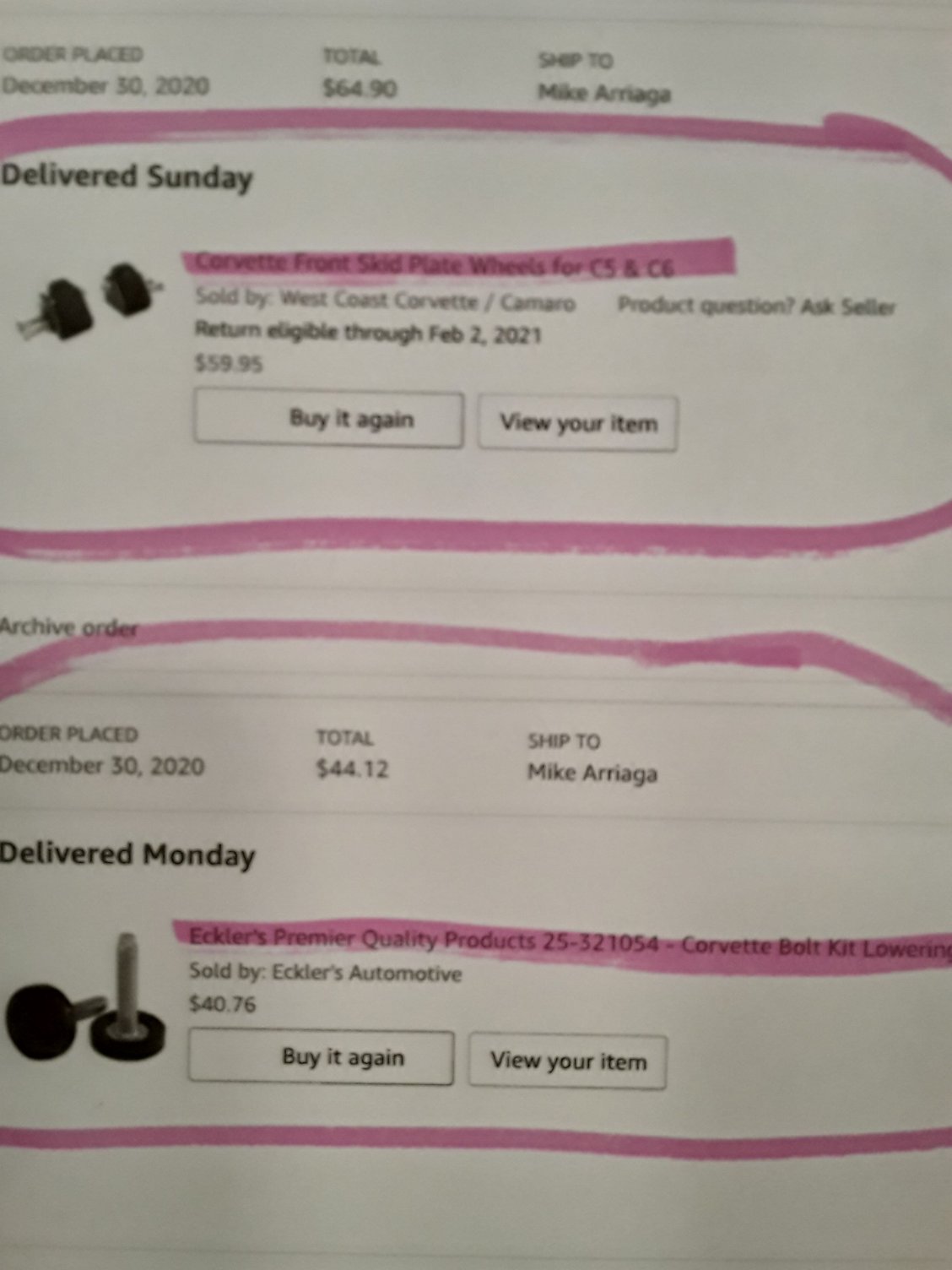

04 c5. Lowered rear bolts all the way( untill no more threads exposed)floor to center of fender 28". Lowered front all the way(allthe threads exposed). Front was still about 27.2 from floor to center of fender. Was too high still. Big gap between tire and fender and body was level, i do not want level, want slight rake. Removed front lowering bolts, replaced with aftermarket from pic above, lowered front to 26-1/8 which made perfect slight rake and perfect gap. Items are pictured above. Added anti scrape wheels pictured above.

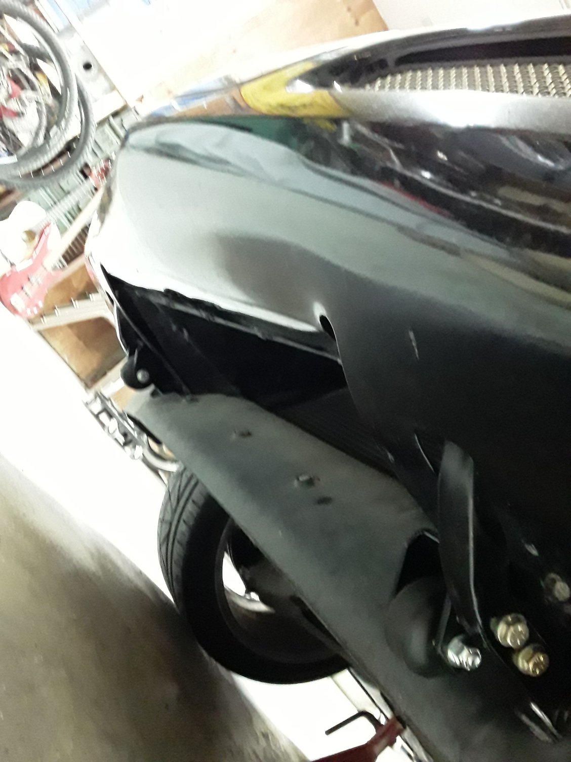

Man I didn't take before pics. I can take after pic in morning. I threw car cover back on in garage and came in. Here's the wheels mounted on the front braces which is where all corvettes drag going up driveways. I'll take pick tomorrow of stance.

How difficult was the install? Did you have to dril holes in the lower support for the roller wheels?
Old Jan 13, 2021 | 06:42 PM
Smoken1's Avatar
Smoken1
Joined: Apr 2013
Posts: 5,046
Likes: 1,160
From: Oregon
Yess you have to drill the support that is why I went with the fangs instead
