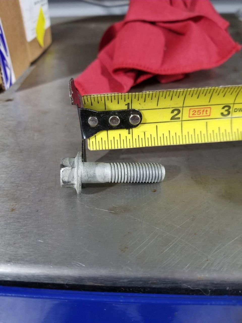

Looking to see if anyone knows the correct bolts sizes for joining the T56 trans to the rear diff.?
Thanks in advance!

I'll help. I have mine out right now----- M10x42 for the top and M10x33 for the sides they are 1.5 pitch...…

FYI - the top ones are bolts vice studs as the parts diagram calls them.
