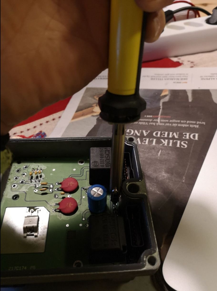

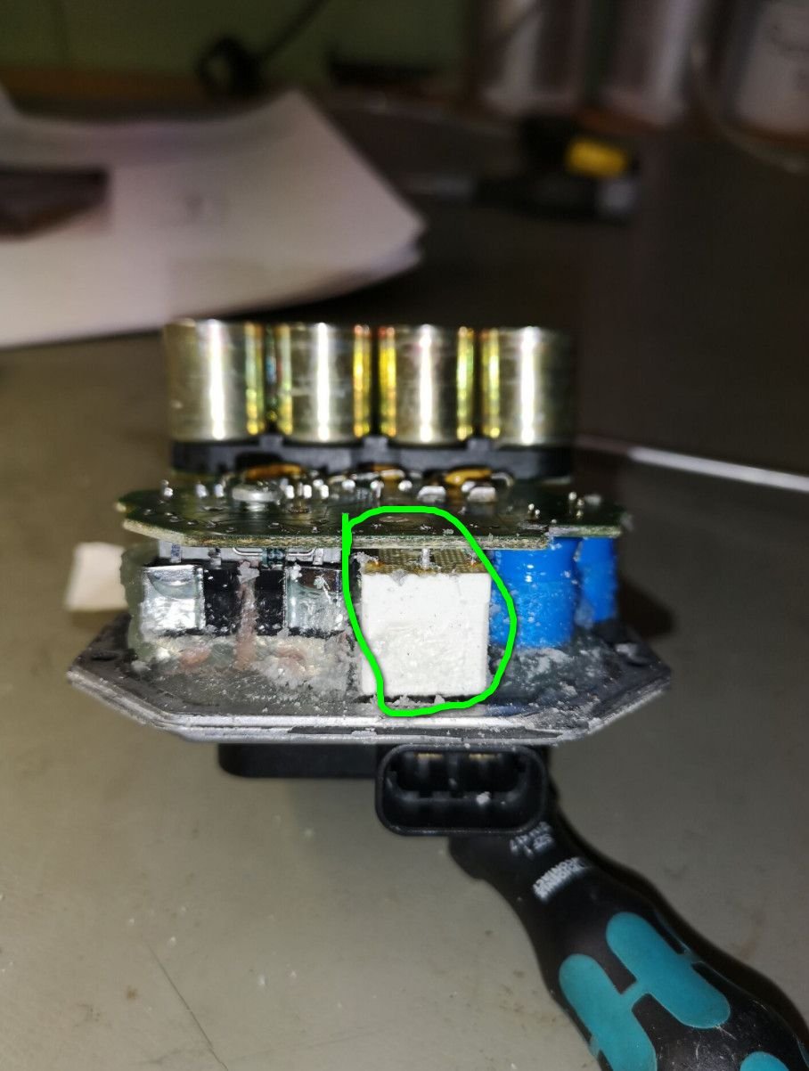

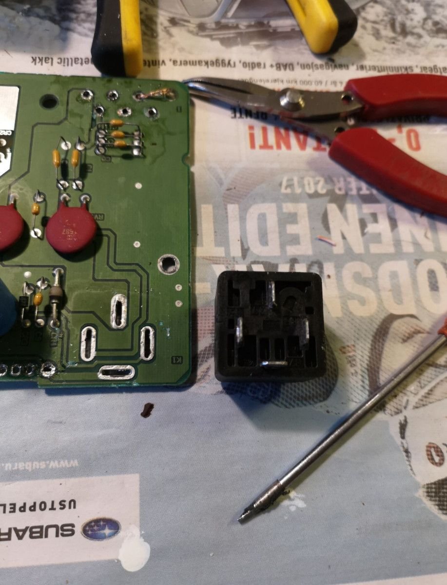

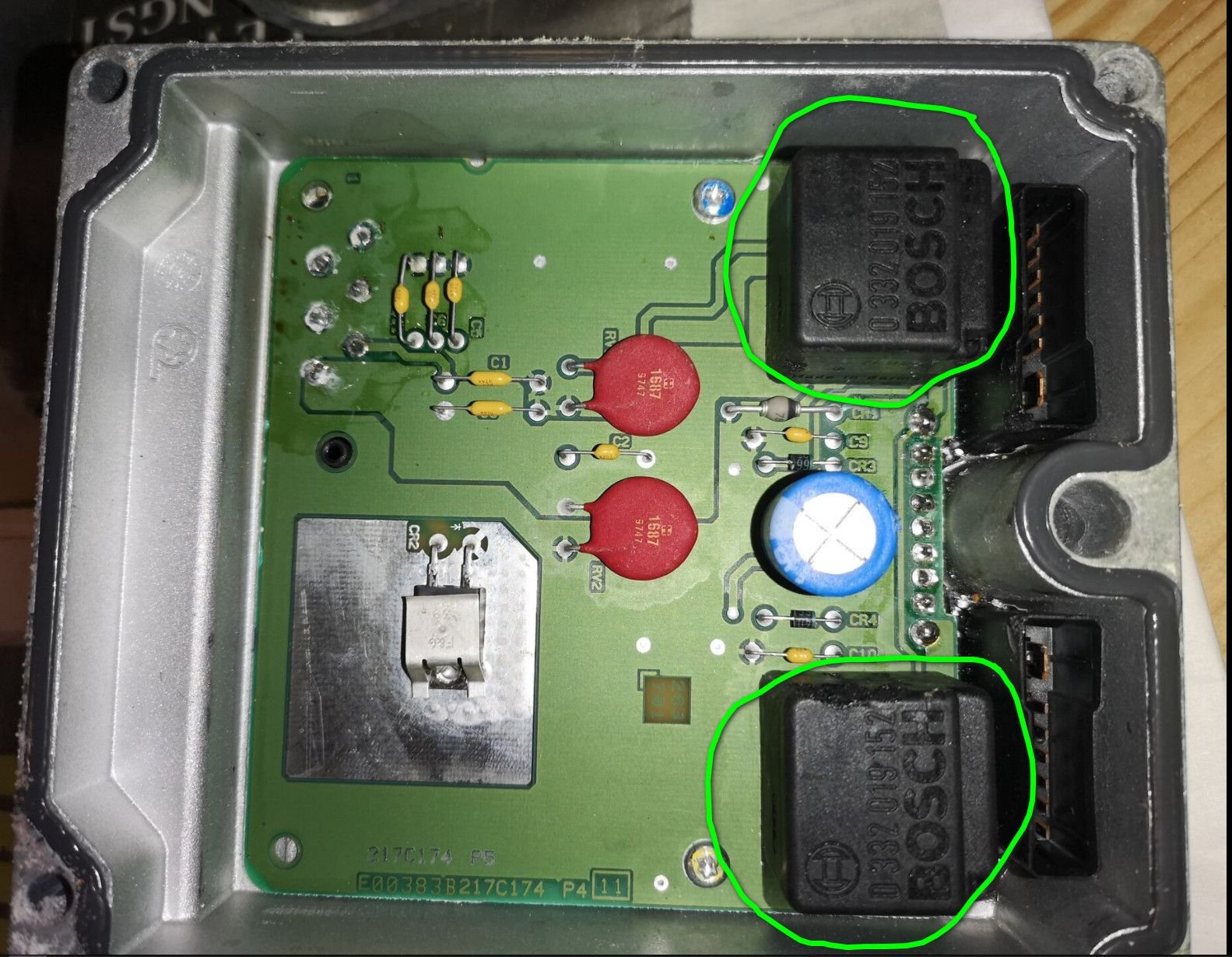

If you get the EBCM internal malfunction DTC all years of the EBCTM are not repairable and needs to be replaced .
The C1214 DTC on 01-04 is mainly caused by soldering issues or a defective relay supplying a 12volt to the ABS pump and valves .
My guess is that the high current is burning it's internal contact .
I have a 2000 ( old EBCM) and on my EBCTM you have one relay supplying 12 to the ABS pump and a second relay supplying 12 to the solonoid valves .
These relays seems more solid than the 01-04 relay and I do not think that I will get the C1214 (solonoid) or the C1217 (pump motor) DTC due to less current
split on these two relays .
I bought a cheap Caddillac EBCM (similar to my C5 ABS unit) to check if it was possible to replace these two relays if needed sometime in the future
I was able to replace these relays and here is a couple of photes from the job
