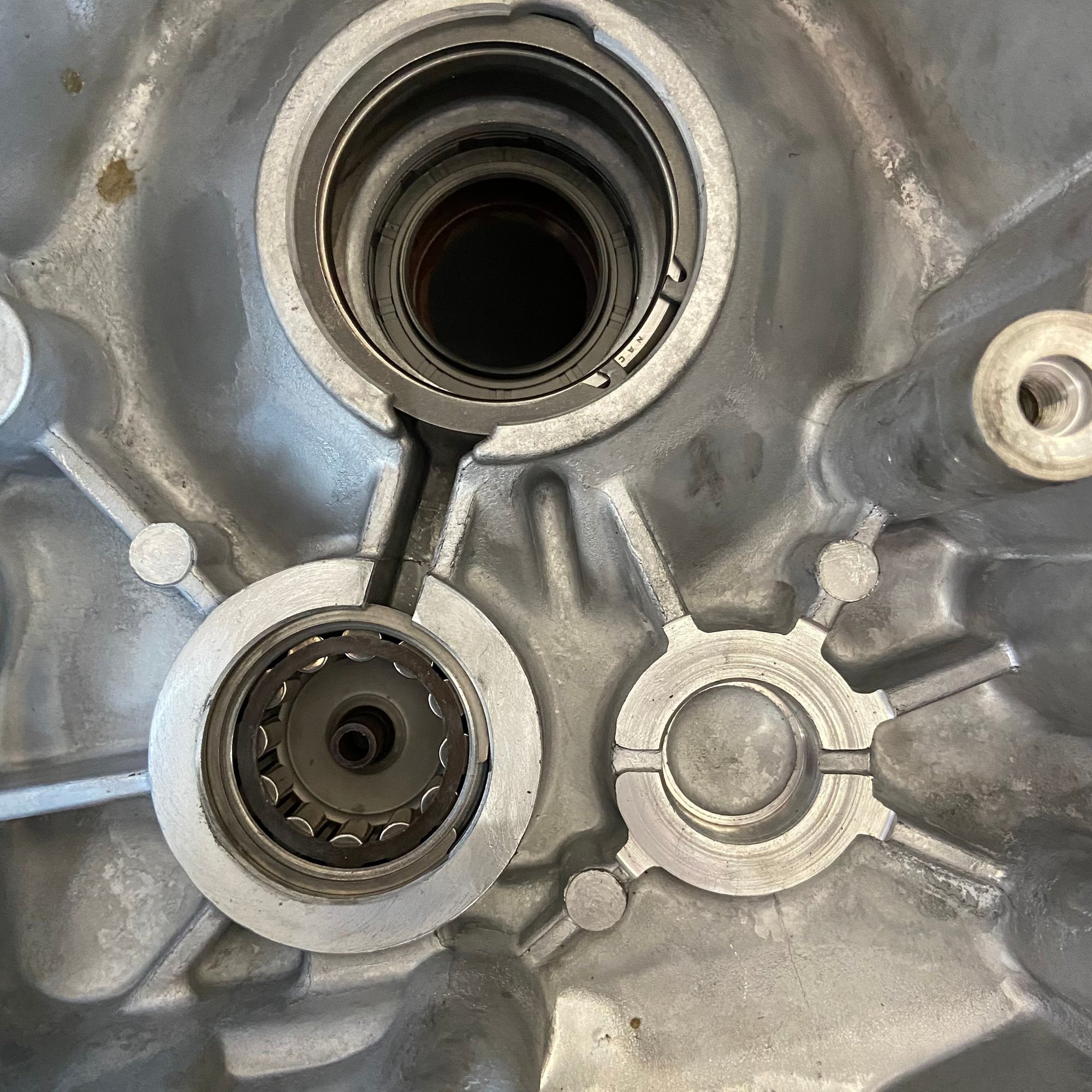

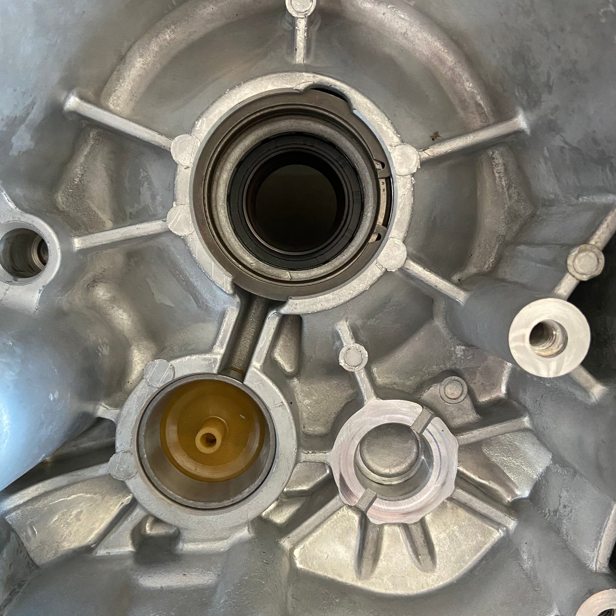

You will need a BASE T56 tailshaft housing from 06-07. The reason you can't use Z06 housing is due to the extension shaft bearing. Base tailshaft housing has tapered bearing like the C5 T56 where the Z06 has square bearing.

Originally Posted by Stroker87
Rick@RKT Performance thanks for the info!
so is the zo6 version 30 spline, is that why it has a different cluster?
This is removable tapered bearing race that's in all C5 and 06-07 base C6 T56.
This is 06-07 Z06 T56 with pressed in square bearing.
Old Jan 12, 2021 | 12:01 PM
rjacobs's Avatar
rjacobs
Joined: Dec 2004
Posts: 2,656
Likes: 635
From: Dallas TX
So its not the main output shaft size that makes the difference its the countershaft bearing setup.
