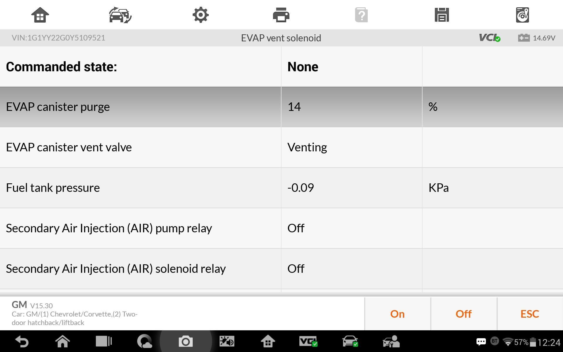

If someone with a Tech2 or another bi-directional scan tool can help you out it is possible to verify if the EVAP Vent valve and the EVAP Purge Valve operates .
With a tool like mentioned the fuel tank pressure can be observed while these valves are operated manually with the scantool .
The Purge Valve is in the engineroom and the EVAP vent valve is under the car in the right back shown in the photo .
If the vent valve are closed on command by the scantool the tankfuel pressure wil go more negative ,
With the car idling and Vent valve open I observed appox. 1.5 volt from the fueltank pressure sensor (-0.84mmHg ) increasing to 2.6 volt (-9.27volt) when I closed the EVAP Vent valve for some seconds.
