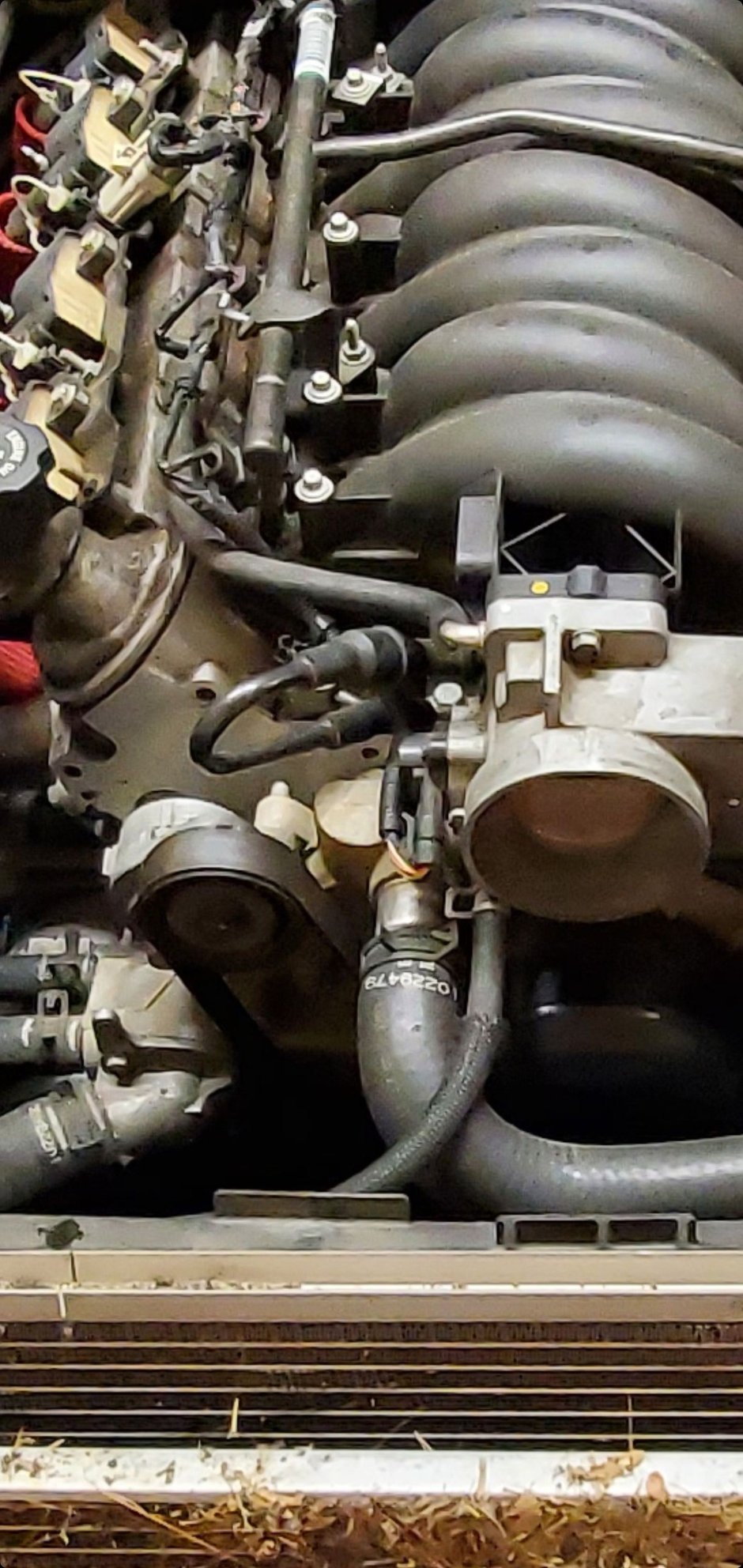

Pink number 1 in my post above tells me you have an ls6 valley cover. Do you have a photo of this side of the motor before it was disassembled?
This is before-
Old Feb 3, 2021 | 01:58 PM
Chogan835's Avatar
Chogan835
Joined: Jan 2021
Posts: 314
Likes: 61
Whoa. That’s not what that’s suppose to look like. Do you know who did that to your pcv? I would ask them why.
No idea but it's just a PCV valve in between the valley and the intake. It was like that when I got it and the guy before me didn't have it very long. I do recall him saying that the guy before him had something done that was supposed to fix the oil consumption issue. This is the reason I would like to do it the right way this time around whether i need the PCV valve or not lol.

Here is my setup on 03 z06 prior to FAST 90/ 90mm TB install. Circled white is PCV valve. In the picture The black hose from valve cover going into original throttle body is now connected to my halltech cai like in the guide i posted in my previous post.

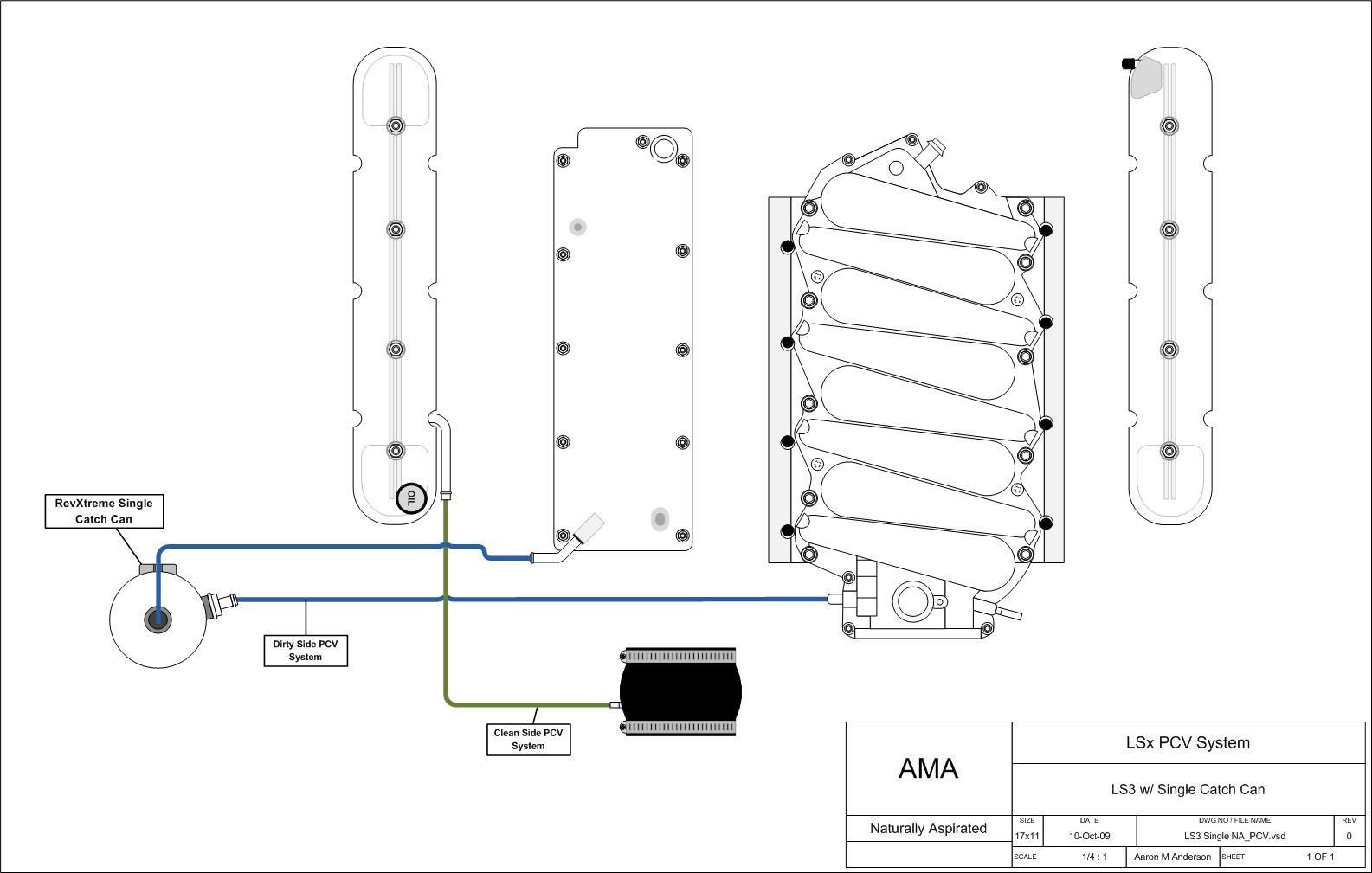

This is the diagram of my setup

Originally Posted by ericba
I assume you reviewed the instructions, right?
Elite Engineering’s PCV Oil Catch Can (eliteengineeringusa.com)
Based on what I'm interpreting of what you have, I suggest you look at the figure on the bottom of Page 5. Center port of the Catch Can connects to your valley cover and/or your passenger side valve cover and the outlet will connect to manifold vacuum. Simple as that. The second outlet can be plugged. If the Throttle Body doesn't have a vacuum port, you need to find an available port on the intake manifold for your outlet connection. Good Luck!
Agree with this, no need for 2nd exit outlet unless you have FI. As per Elite Engineering comment on the product page:
"You also have the option of choosing the number of Exit Ports your Catch Can will have. Most applications will only require (1) one 1/4" Female NPT Exit Port, but you can choose to have (2) two 1/4" Female NPT Exit Ports for Forced Induction set-ups."

He has a Z06 not a base car so he has an LS6... So late or early doesnt matter... Although I do believe there was a change from 01 to 02,3,4 LS6's in regards to pcv in GM's quest to control the LS6 eating oil.
BUT my original description of how to route his can stands... Valley to can inlet and can outlet to FAST manifold. Then either a small filter on the valve cover or valve cover to intake air bridge(either silicon connector or the air bridge itself)...it just needs a source of clean filtered air.
