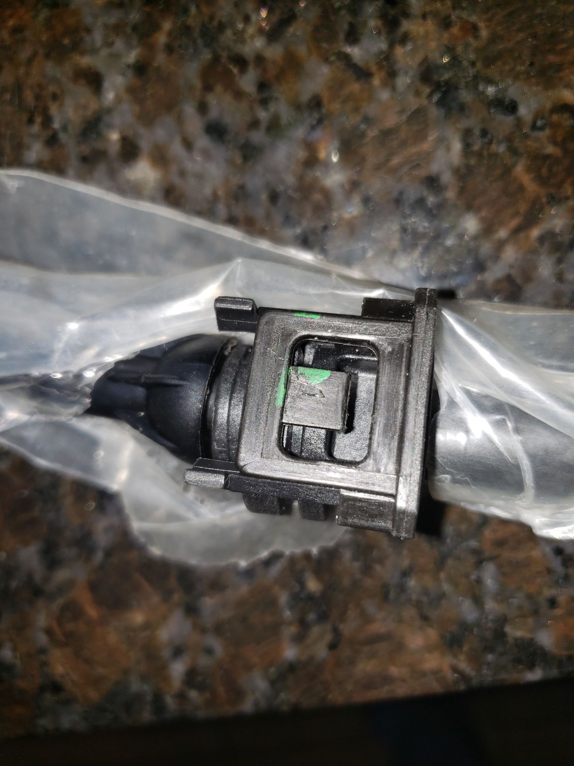

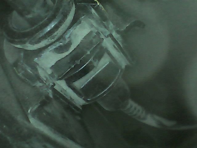

Be forewarned head of time that the '03 had a mid year design change to the cable housing the way it attaches to the mount in the tunnel at the shifter end! One style is the 'horseshoe' clip just like the one that holds the shifter **** on to the shift. The other has two little 'tabs' that stick out towards the shifter that needs to be pinched in together to pop the housing out. Either style is just over $100 from a dealership. Figure out which style you have. Use a small brush, a tooth brush would work great. Maybe a wet paper towel to wipe around the mount. Mine had 83,000 miles of fine dust coating it and with 'standing on my head' with a flash light trying to see why I couldn't pull the cable loose taught me this lesson. Here is a picture of the old cable before I figured out how to take it out. One of the tabs was already broken off.
Here's a picture of the new cable, you can see the tabs sticking off towards the front.

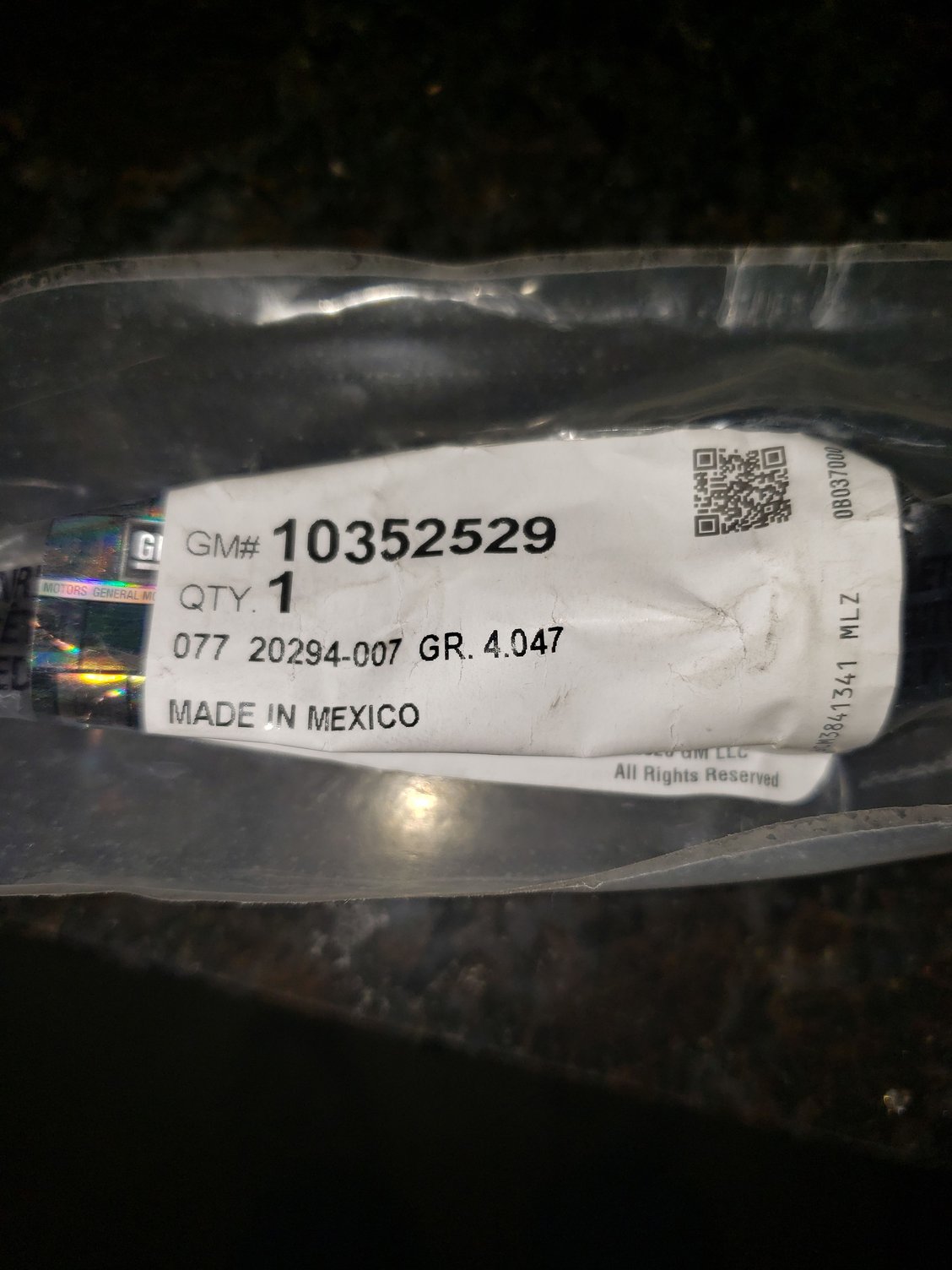

Here's the part number for what I used to replace my cable.
