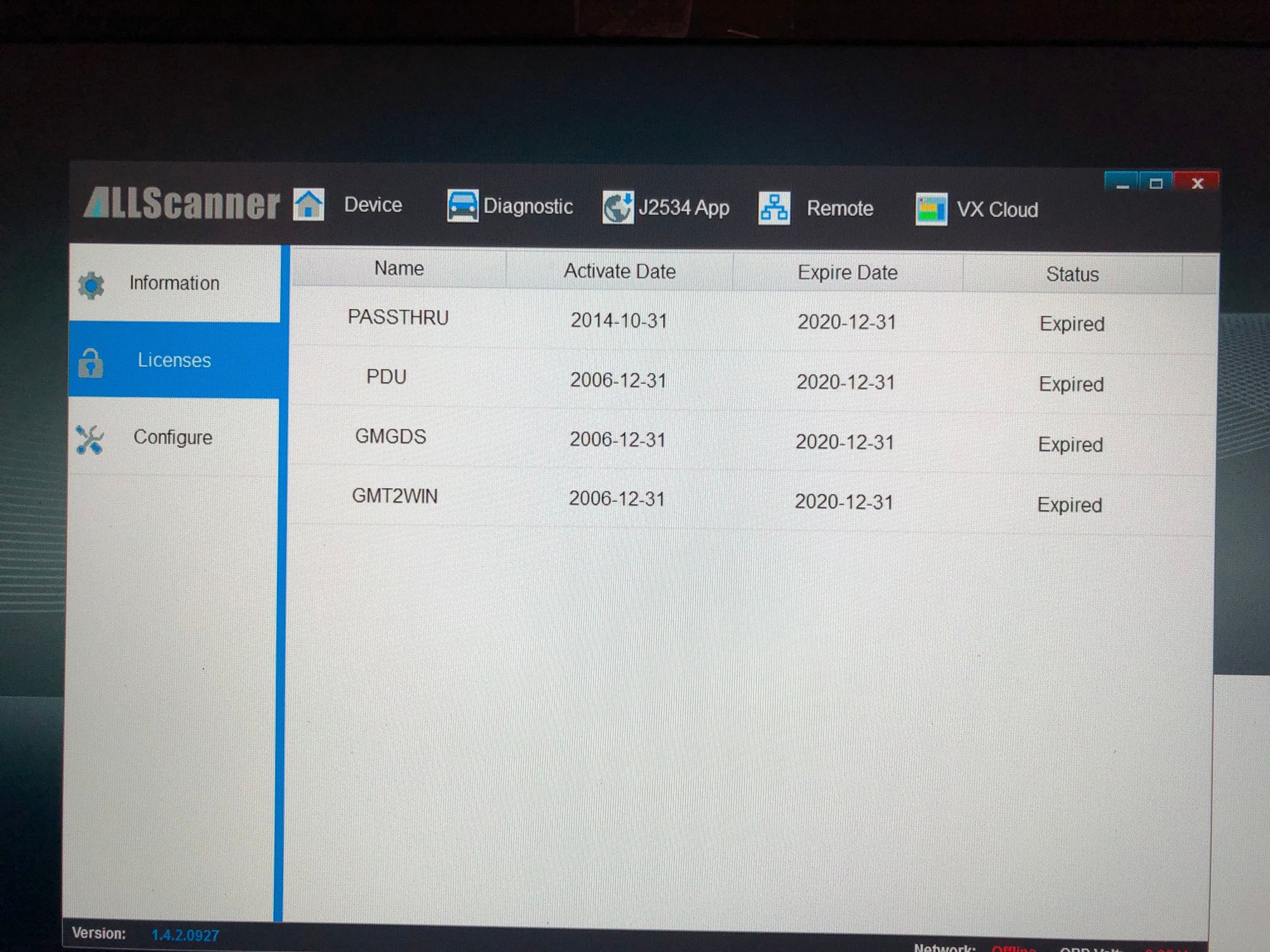

Trying to run Tech2 after having swapped the windows 7 hard drive from an older laptop to a later one with a brighter display. So far so good - but evidently VX diag license expired. I go to the Information page and pick License - it says license has been updated but not really. Any special sites to visit for a license?

Wow - emailed them and got a speedy reply!
Hello
Please download latest vx manager.
https://mega.nz/file/vUAGyDxS#D0VWizy3huB8nK8dtL1FIPgfhMrJGo-isxAjirSlKjg
After download, please install the new vx manager.
Then connect device to laptop, laptop connecting network, open new vx manager, click "Firmware" to update, then click "Update license" to renew.
All would be ok.
