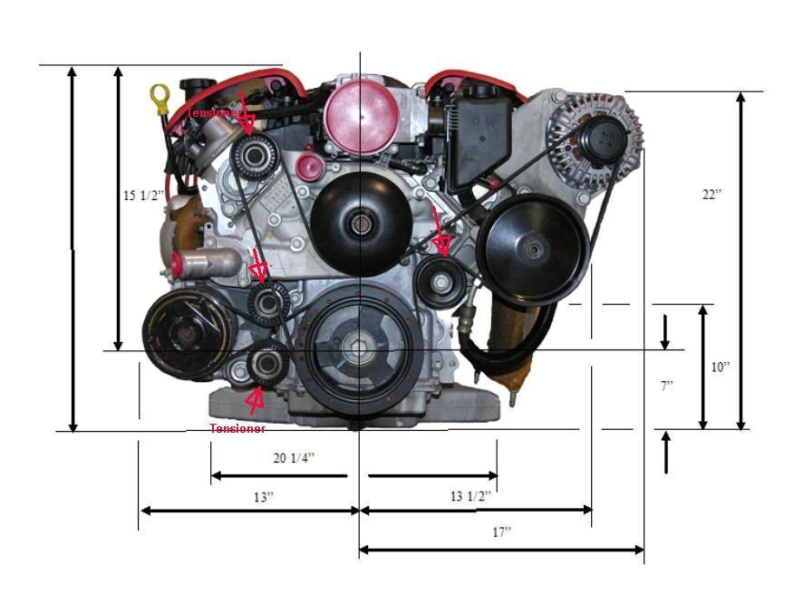

Your OPS is going bad you should not see 85-90psi. You H/B most likely need replaced this is a common problem for these cars.
The squeak could be the belts or any of the pulleys in this picture
+1
Just did this myself...highly recommend you do the extension/relocation while in there. Search it up on the forum and you'll find part numbers for the adapters/hoses etc. Will make the imminent replacement of the OPS down the road infinitely simpler.
