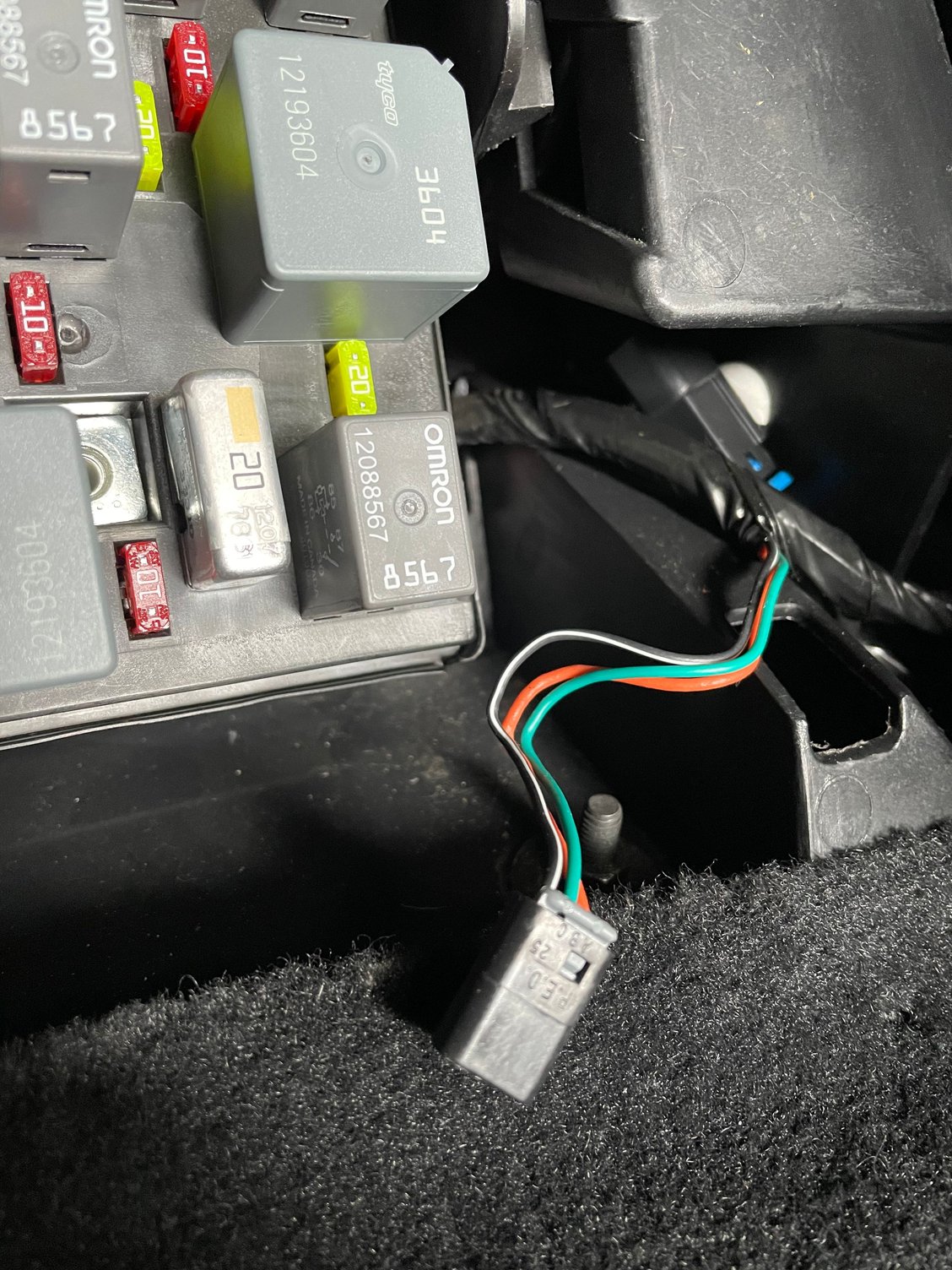

Hello, C5 question. Anyone know what this wire is for? Found it disconnected at the passenger footwell fusebox area. There does seems an end that it connect too. Found it unhooked as I’m chasing down low voltage gremlins. Thanks.

If I am not mistaken it is the wire connector for the cd changer in the trunk.

that would make sense. It does not have one so yeah maybe. Thanks.

Check the service parts ID sticker in the glove box. If U1S is listed then that would confirm the car originally had the "Remote Compact 12-Disc Changer".
HTH
