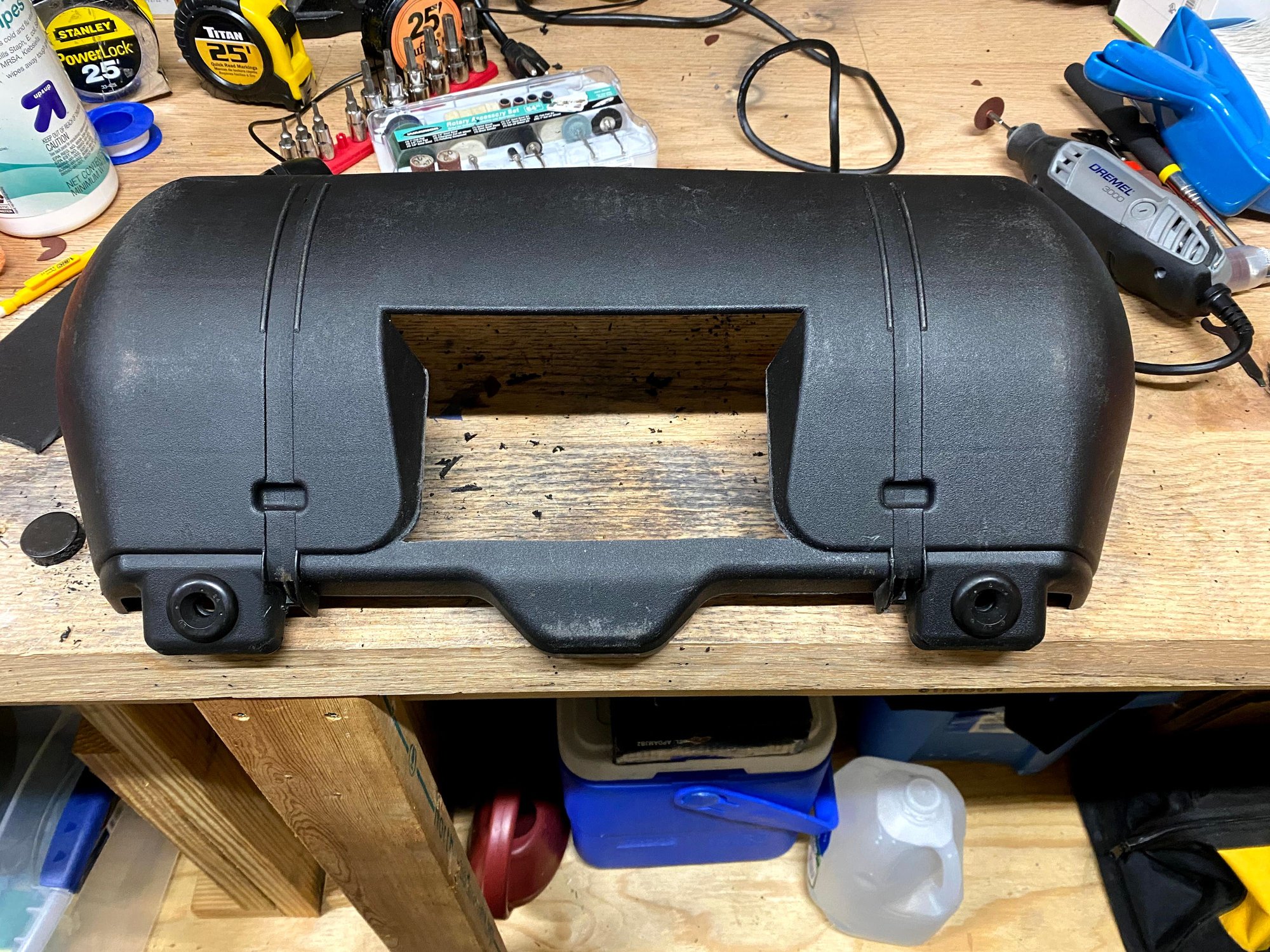

If money were no object, I'd get Halltech Killer Bee Conversion package. It gets rid of the small blow-through MAF, and gives good breathing for larger throttle bodies.
https://www.halltechsystems.com/97-2...7-2000conv.htm
That said, I use a stock paper filter with a modified Z06 airbox. The tuner told me that the car is still "breathing through a straw" when he got done tuning it. (243 heads and a decent-sized cam made 415 at the wheels). He said that judging by the MAP readings, I was leaving an easy 20 wheel hp on the table by using this airbox over something aftermarket.
