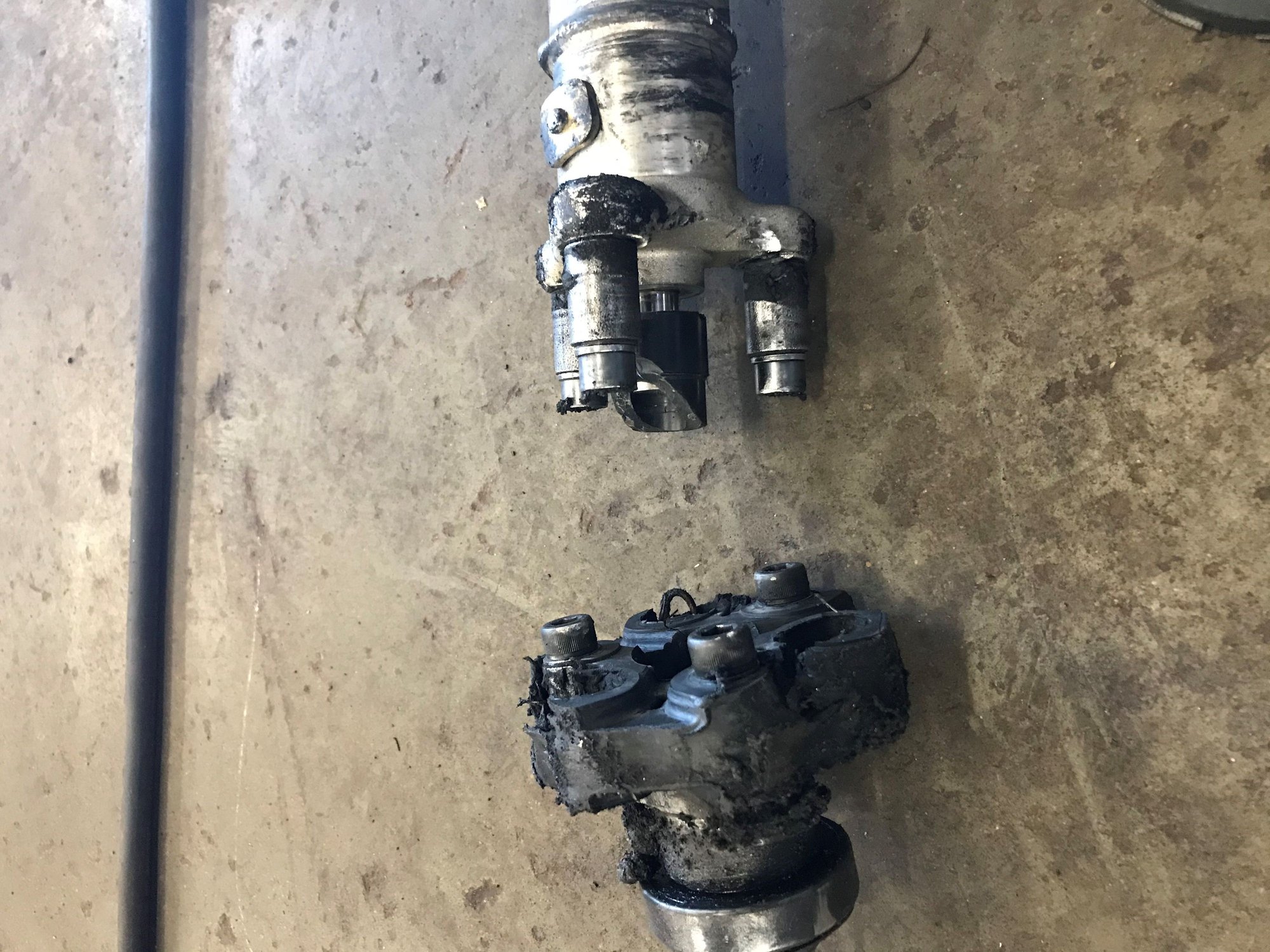

so the upside so far is we found some issues. the torque tube is destroyed. and i mean destroyed. I will get some pictures when i get over to the shop. Naturally the PO said the tube was just rebuilt, but i have since watched a few videos where if the inside shaft wasnt seated perfect, it could walk and then destroy itself. At this point its looking like thats the case.
On the upside, it appears that it is in fact a spec clutch inside the bellhousing. We are trying to avoid pulling the bellhousing if possible. but will make that decision a little later today.
Right now it is all about deciding if the inner shaft cut into the tube itself enough to trash it. or if anything is salvageable.

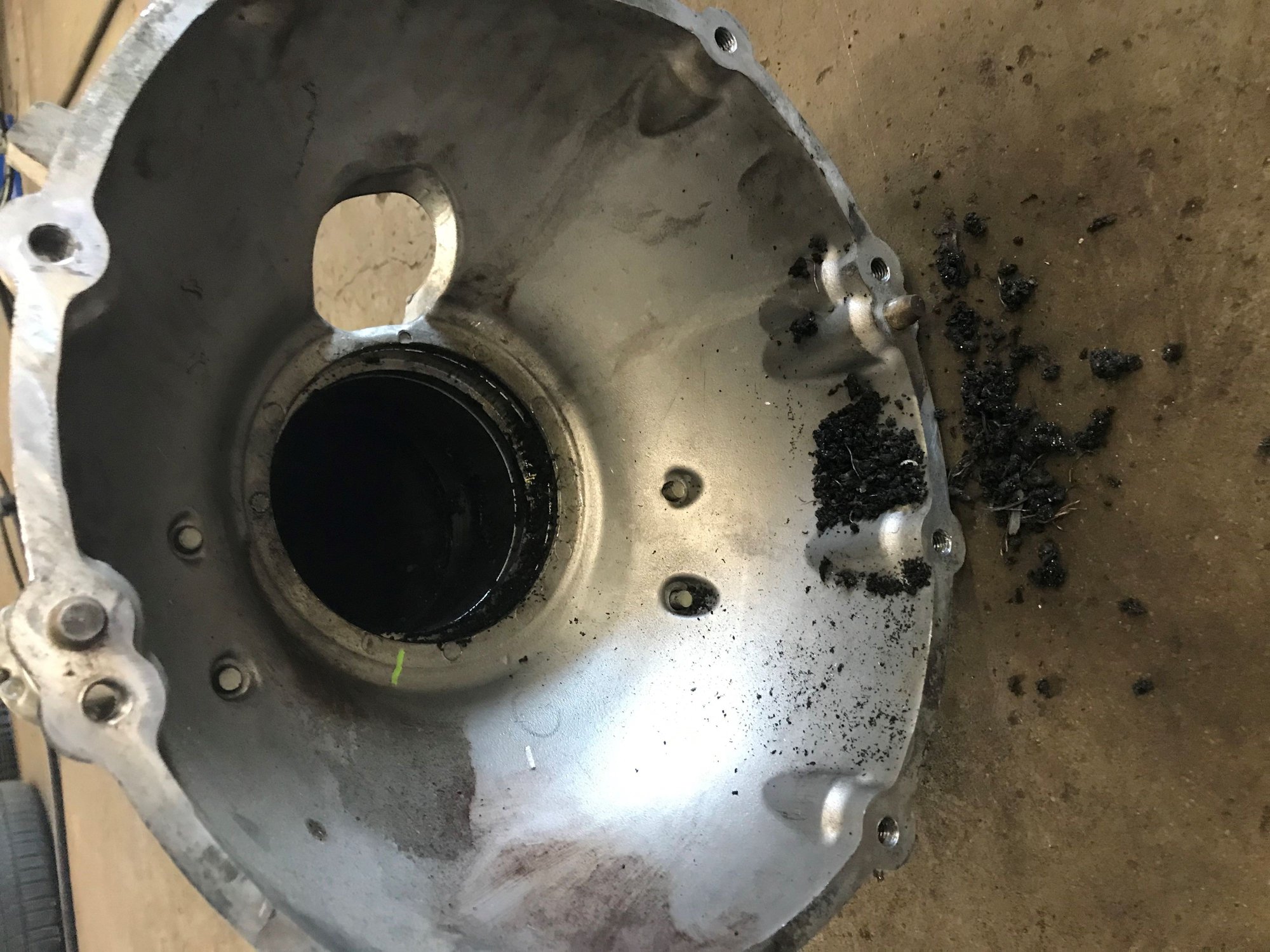

some pictures of the torque tube after removal. replacement going back in today
