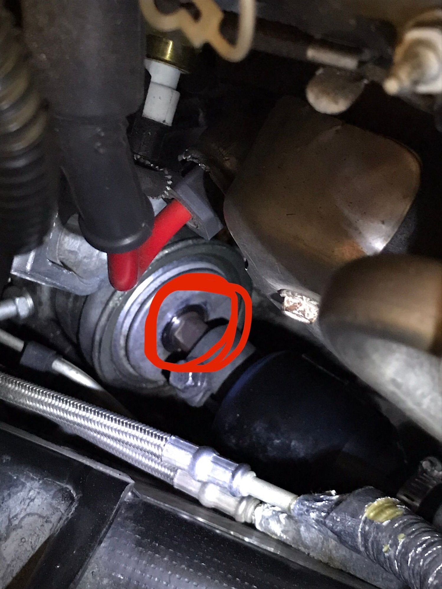

Hello,
I have a steering fluid leak where the shaft meets the rack. (Please see pic). The oring is saturated and appears to seep down slowly underneath the pinion assembly and then drip on my garage floor. Does anyone know if this is an easy o-ring to replace or is a rack rebuild necessary? Thank you!

Call Turn one and see if they will sell you what you need

Thanks. I’m just wondering if this is an easy replacement. Turn one does full rebuilds.

Since there is no part # for that seal I was thinking Turn one my have it

I was thinking about just picking up an oring at the parts store. Looks to be a standard size. But thank you! Appreciate the help.

part number is GM26056695.
